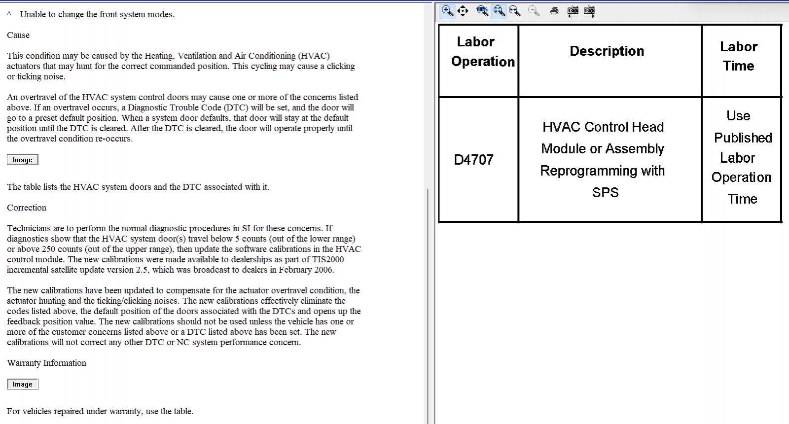

Oookay
Update
So, it seems to be over-ranging when set to outside-air. Which swings the door towards the interior against some plastic grating.
If I stick my fingers in there and stop the door from ranging all the way, it works fine.
If I remove my fingers and allow it to go to to full-range, issue presents itself again.
So now the question becomes....
How do I constrain the things movement?
OR
Is this doable in software - extend the allowable range such that it won't error?
