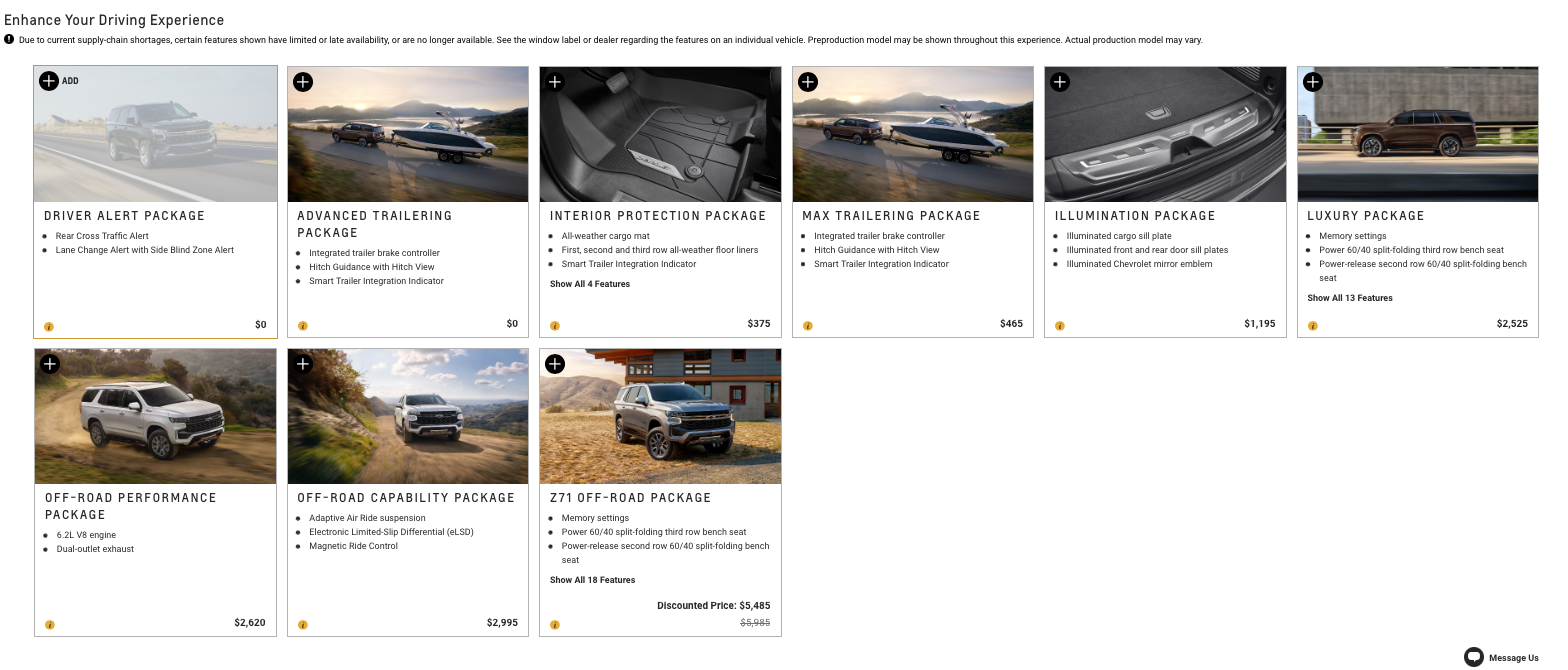

That's what confuses me. In the "Build" page of the Z71 it shows this:

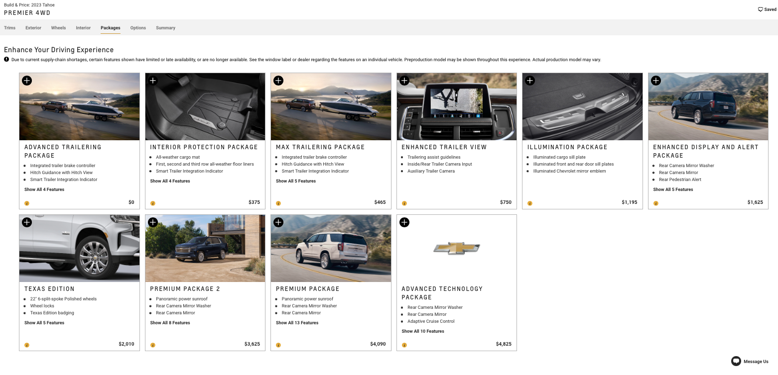

But in the "Build" page of the Premier it does indeed show the Advanced Tech Passage:

The rear view camera mirror is not available oem on the Z71 no matter what package. The camera mirror is only available on the High Country or Premier with the packages you show.
For Z71, you have to add the camera mirror after the fact.
