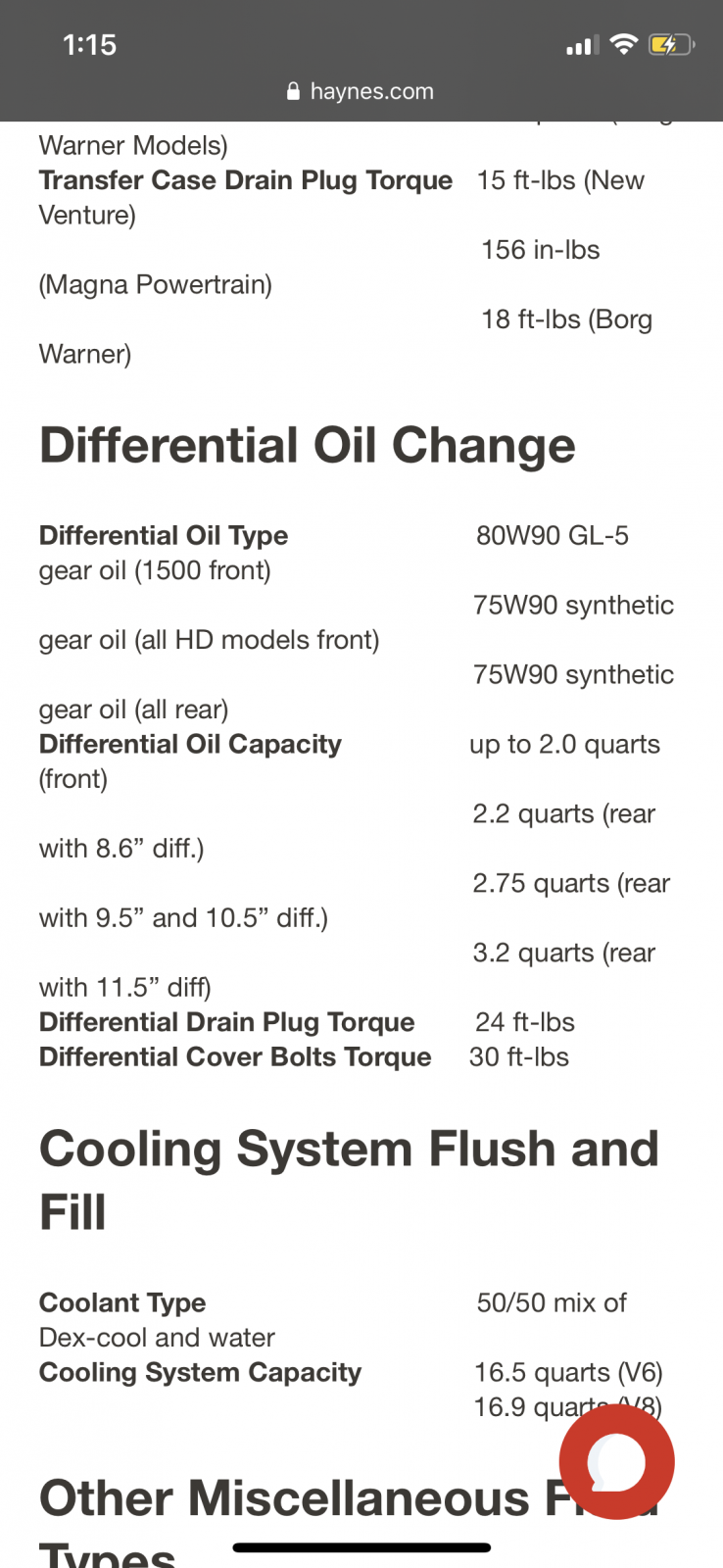

So I’m trying to figure out what size rear diff I have. Can anyone confirm that it’s a 8.6” 10 bolt? I know it’s a 10 bolt, but I’m not sure where I need to measure.
Apparently I can find this in the RPO codes, but I’m lost...
Here’s a list of what the codes mean, but still can’t find rear diff size...
http://www.denalitrucks.com/documents/new/2007 YD printbook.pdf
I’ve got a 2007 GMC Yukon Denali.

The GU6 is the 3.42 gears and the G80 means it has a limited slip. It is the 8.6 rear axle.
Great, thanks! Mine is all rusted (got WD40 rust *********** spray soaking in the bolts now) and plan to replace it with a new gasket, bolts, and cover.
