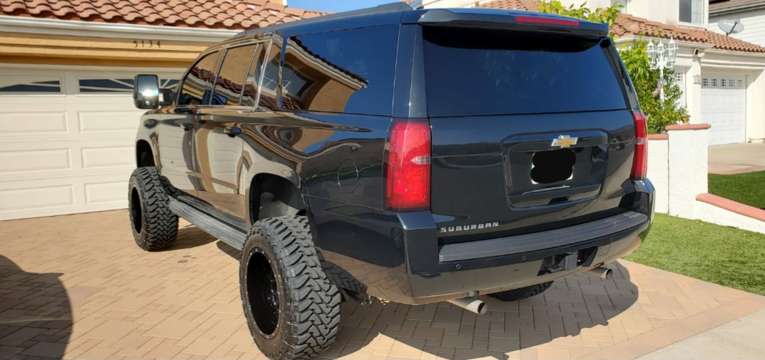

Burbanator
Burbanator
Aug 24, 2022
You should be all set with those rear shocks that fit the 1500...
Pics posted of your 7" lifted rig?
This is what the truck looks like, sitting on 35x12.50 toyo mts. In about a year or so I'll be upgrading to 37s, just need to set the new bilstein shocks I have to give 8 inches of total lift in the front.
