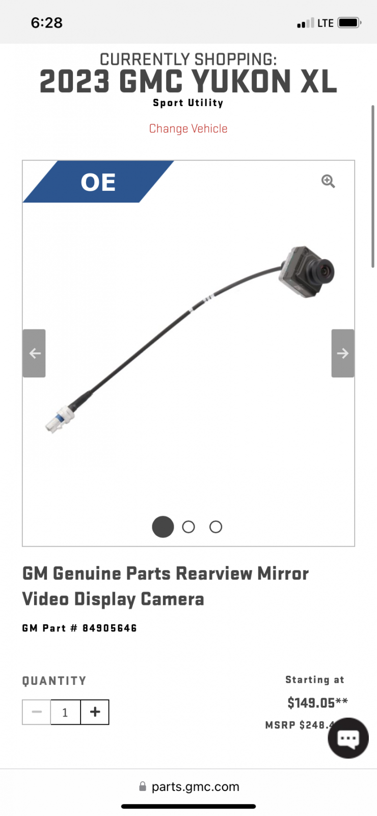

Yes, you can, I did it to myself on my Denali. Here is a post about it.
This requires 4 parts. Mirror with screen inside and TV cable included. Separately, a block with two cameras, which is placed instead of a rear view camera on the tailgate. And I hung some more ferite filters because I had interference, but this is optional. In fact, the installation itself is not difficult. Everything is plugged in there. But you also need to take the water outlet from the rear window washer, and bring it to the block with two cameras, because there is a camera washer.
I bought this on ebay. The mirror cost about $500 or $600, the camera unit about $120.
