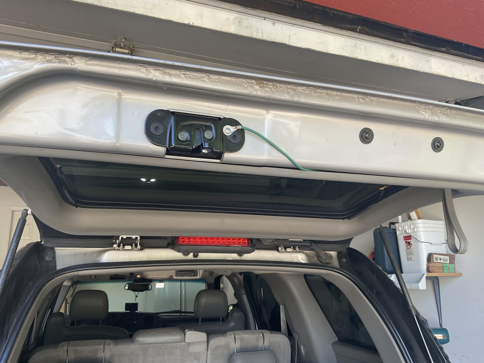

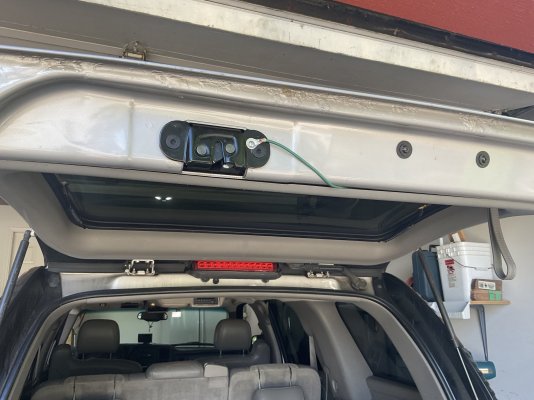

Not sure if this helps. My 05 Tahoe rear wiper motor did not work since I bought vehicle used about 5 yrs ago, checked fuses, etc..
I toyed with the idea of replacing it until I read ’somewhere’ that sometimes grounding does not work on these very well - read door is basically aluminum, sometimes causes grounding issues.
I ran a ground wire from the rear wiper motor under the shroud (cover) and attached to other end to the latch mechanism for the rear door, ensuring a steel to steel ground. It worked!!! - first try and has continued to work now for almost 5 years - no issues!
