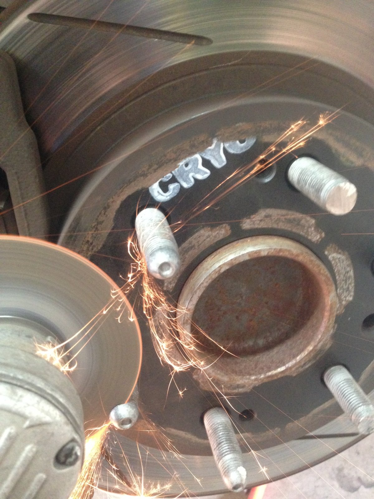

I ran some 1.5" spacers I got off Amazon for about a year when I had a small lift. Branded "DCUAUTO", $89 in 2017, now $129. I don't tow anything heavy, but I often take corners as fast as possible. I put them on my brother's '05 CC Sierra when I lifted it on slightly larger than stock tires. He drives fast and tows his RZR, 4-wheeler and dirt bikes on a trailer with the bed loaded with camp supplies. Never a problem. Whichever you get, I strongly recommend you get hubcentric. Also, with anything less than 2", maybe 1.75" thick, you might have to trim the tips off your studs, depending on the wheels you have. Just the unthreaded tips, nothing critical.

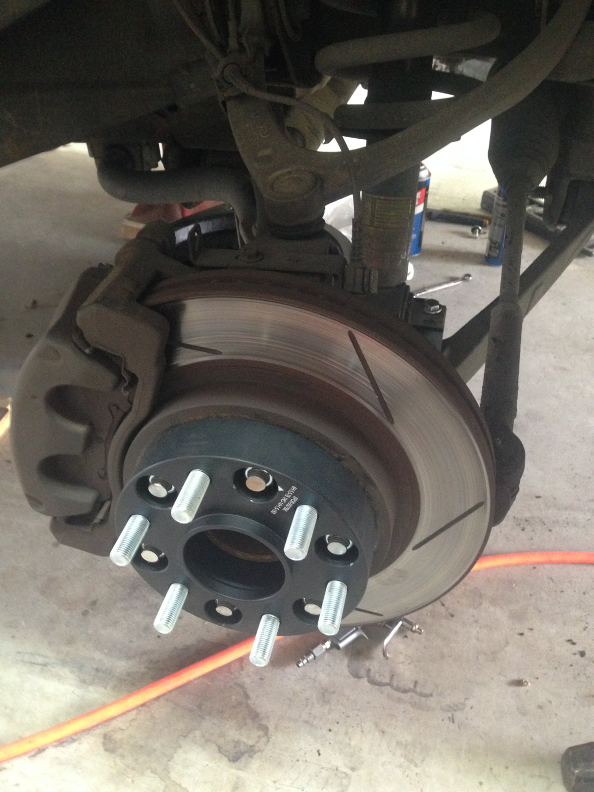

I run these on my 2004 Tahoe. Gave me the stance I wanted. Torqued to 140 ft-lbs, re- checked after 100ish miles, and they retained the torque settings which gave me confidence.
