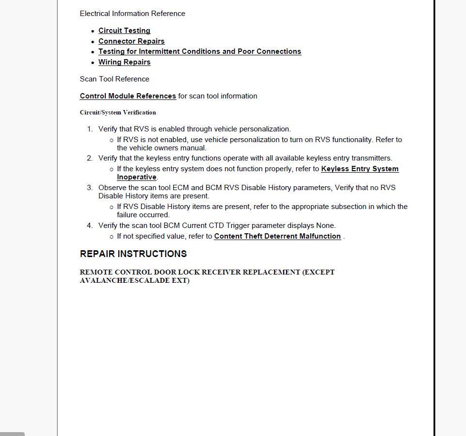

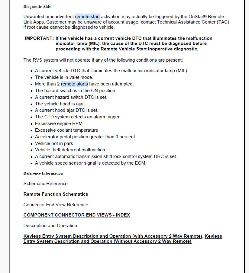

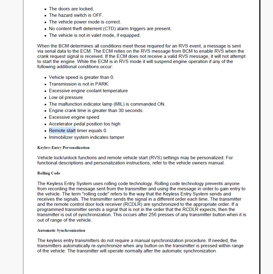

I'm still no closer to resolving my remote start issue. Have eliminated a bunch of possibilities, but not sure where to look next. One question: Tech 2 says there is an "ECM Abort." Does that mean the ECM is aborting the sequence due to an internal check it is doing, or is it being told it needs to abort by some other module? If it was the former, it would narrow down the possibilities a lot, i.e. only things within the ECM's purview, but if it's the latter, it could be anything telling the ECM to abort the sequence.
Does anyone know if there is a diagnostic tree in the shop manuals/AllData?
