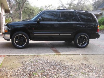

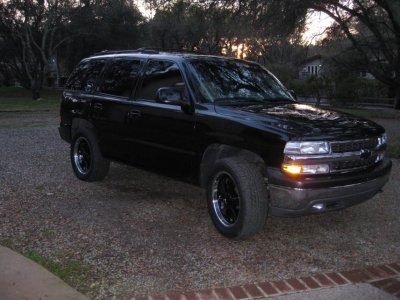

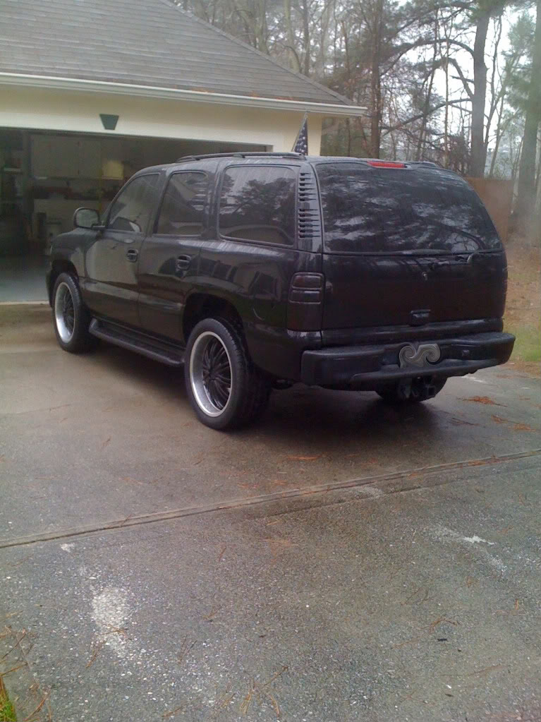

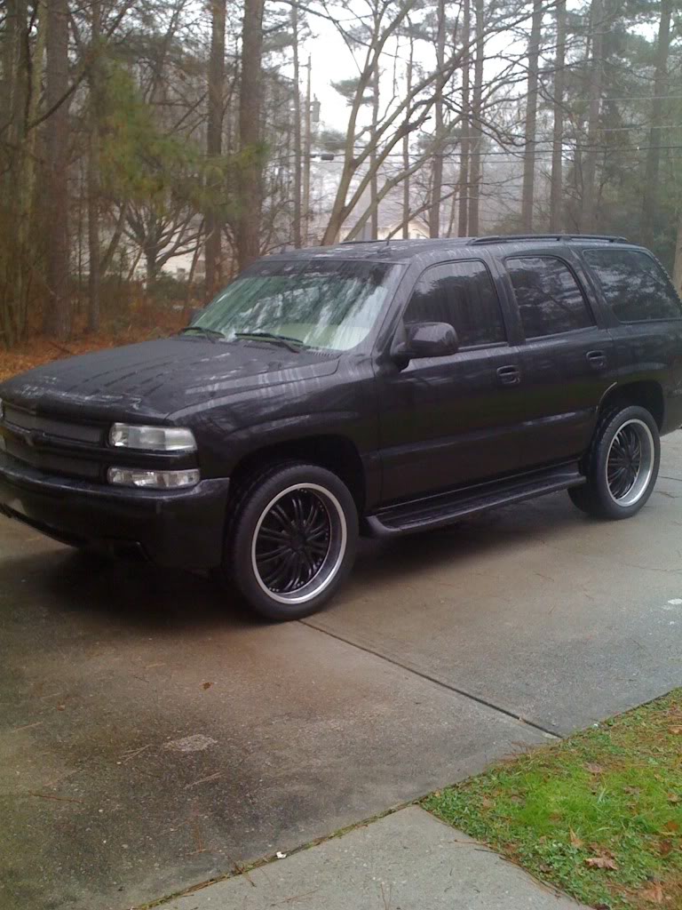

Here are some pics of my car after it was all done and one of it before with the side molding still on.. sorry there not that good because the sun was going down. I'll take more and post them tomorrow. Thank you for all that helped me with my questions and gave me pointers!! You know what your talking about!! :)
