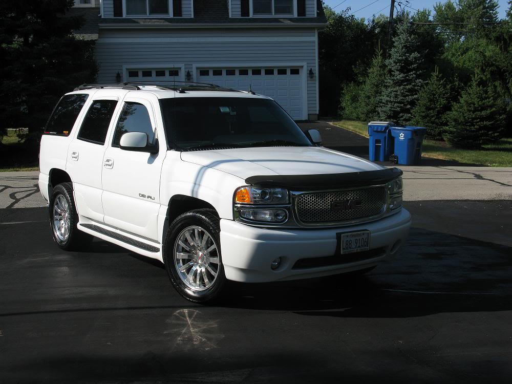

I ended up disconnecting the ride control and air ride (modules located behind the plastic covers in the rear passenger side) and going with Bilsteins. I have no error messages.
Front: BE5-6500-H0
Rear: BE5-E380-H0
Parts and labor cost me $450.
It rides great and I love the stance:

Wow, that Denali looks sick. Those rims have the center GMC caps, are those from a more modern Denali? Those look amazing. I'll have to watch craigslist for some.
uvacarbuff
Jan 23, 2011
59
Thanks. The wheels are 20 inch and were optional on 2005-2006 Denalis and Escalades. They are model number CK628. I put 305s on them and it really fills the fenders.
