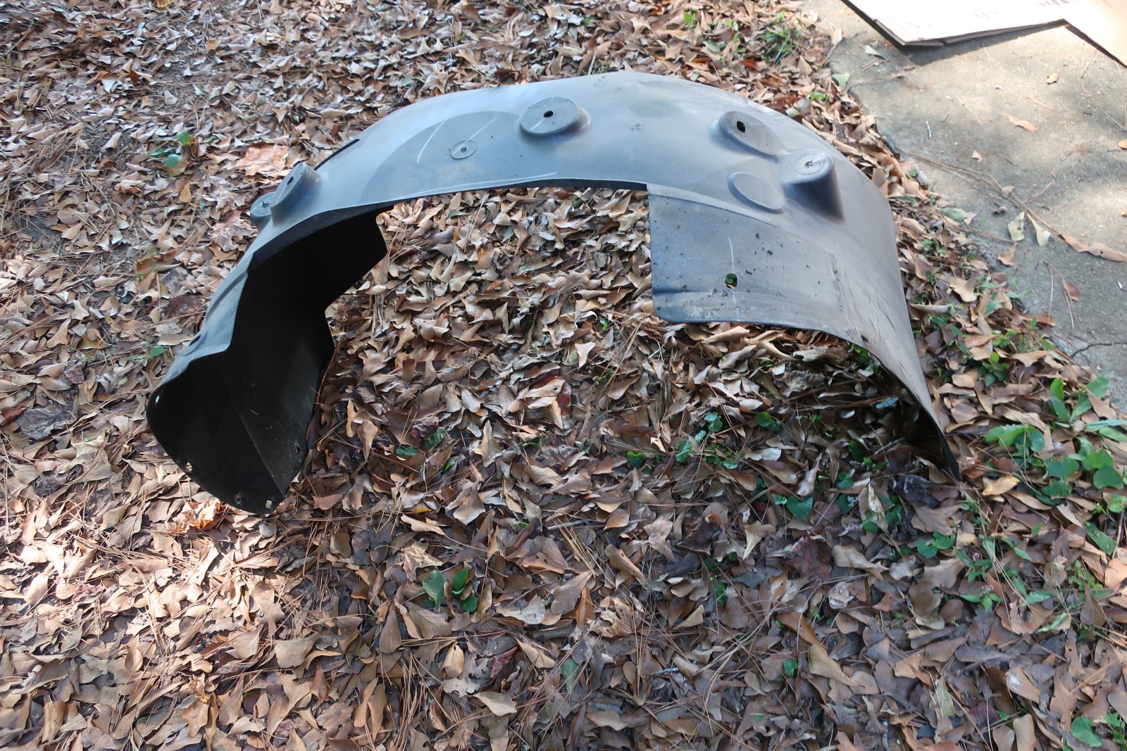

Fender liner removed and out of the way. My outside cats loved investigating it.

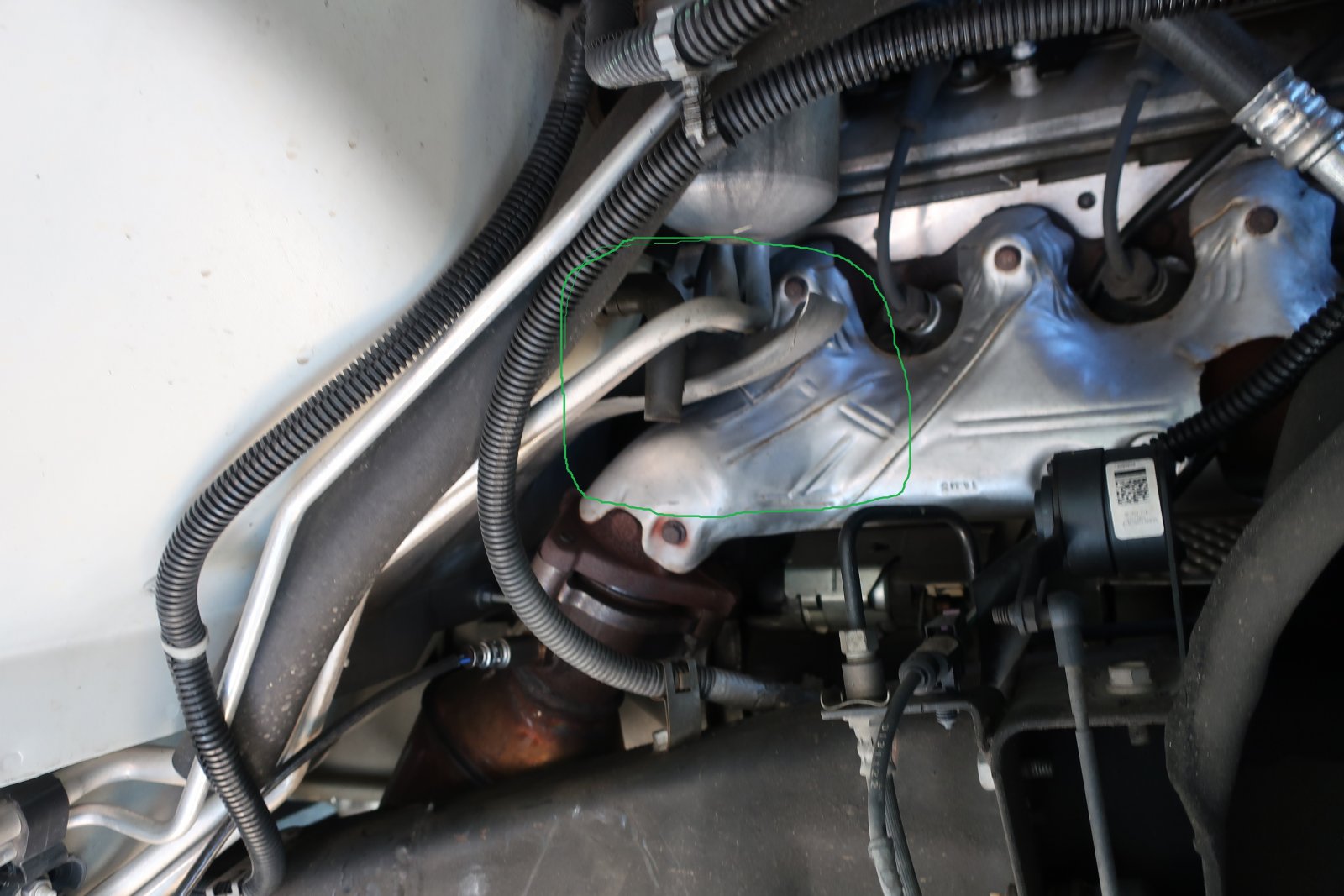

The dreaded #8 spark plug on a GMT-900. Can't even see it. And...because of the heat shield and bottom of the AC accumulator, I can't even fully get a hand on it. Yay.
By using a combination of dexterity, both sets of fingers, long needle nosed pliers, short pliers, spark plug socket, ratchet, other sockets, desperation, violence, and more than a few curse words, I got the boot off the spark plug and removed the spark plug.

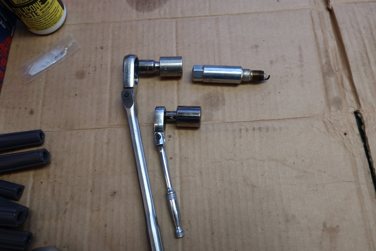

Some of the tools required to R&R #8 spark plug.
Installing the new spark plug was only slightly less of a fiasco. Though I did drop the plug and socket down between the exhaust manifold and the engine. I was able to fish out out with a magnet on a stick. With the above mentioned dexterity, I got the plug started in the hole and threaded it in smoothly by hand. Amazingly, I was even able to get a torque wrench on it! 11 foot/pounds and that one was done.

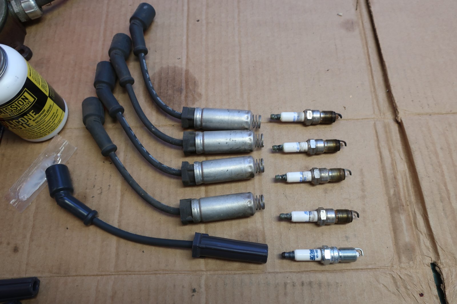

Truth be told, I pulled all four spark plugs and wires from the passenger's side before I replaced any. I wanted to get a photo comparing old to new.
Spark plugs and wires from the passenger's side, new at front, then starting with #2 and going to #8 at back.
New at left, starting with #2 then going to #8 at right. Burn looks OK, though I am told the LS engines in the GMT-900 trucks 'run hot.'

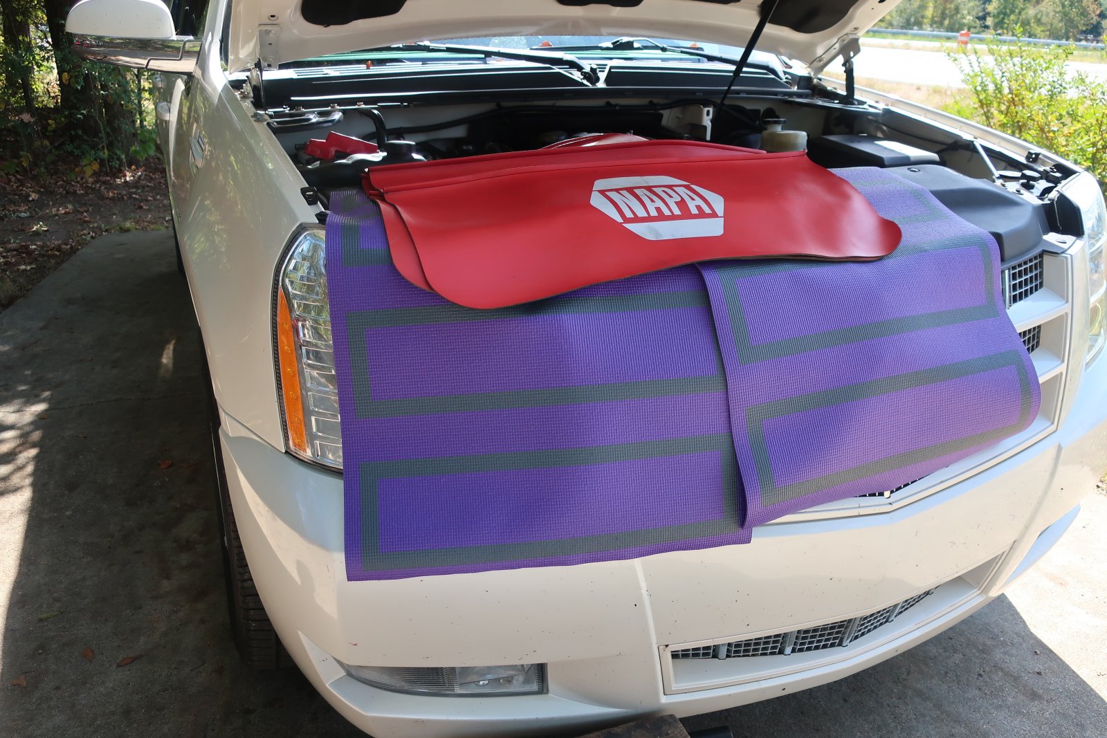

Padding to protect the nose and top of the front end of my Escalade.

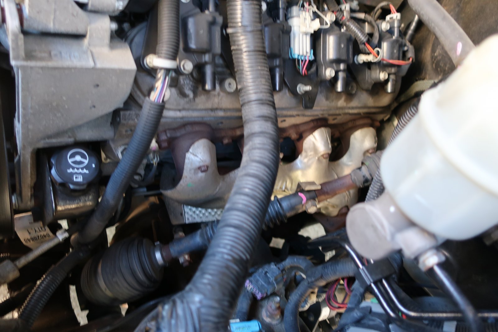

Simple yet relatively ingenious stand for me to get access to the engine.

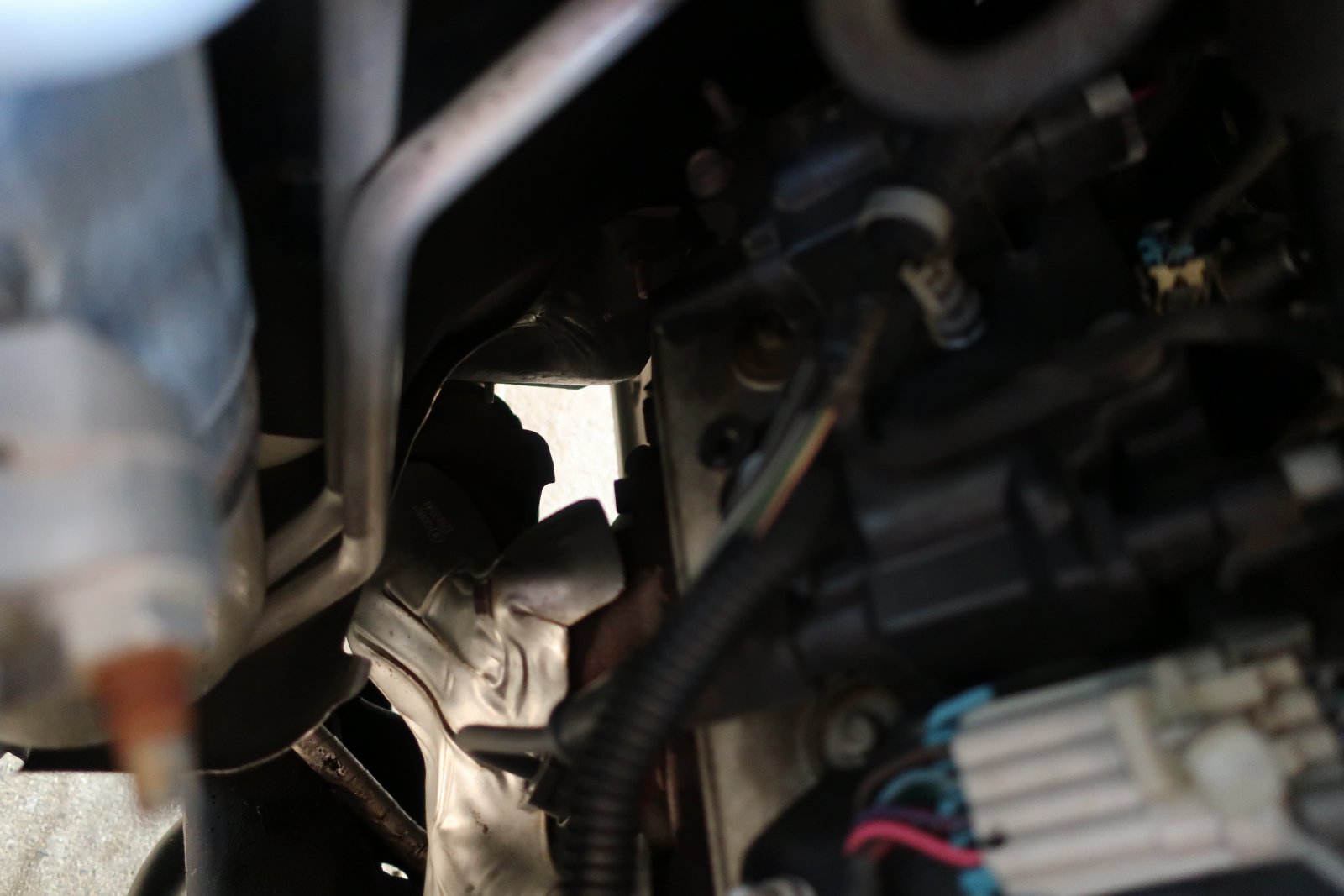

Relatively straight shot down to #8 spark plug. See that very out of focus slightly rusty stud on the AC line connection at the accumulator? I am pretty sure I have a scar in my left forearm from this. Next time I do spark plugs and wires, this will get covered by a rubber cap or something. It is RIGHT in the way of my arm.

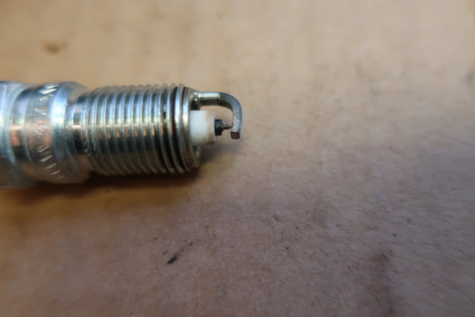

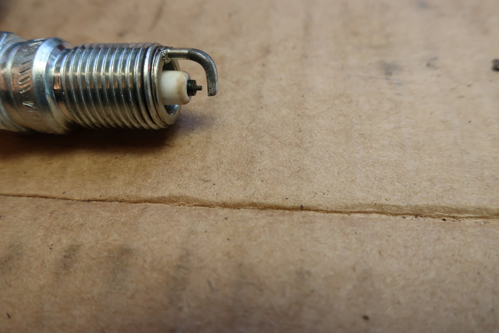

Sooo...I pulled #8 spark plug. And immediately found the problem.
Do you remember when I said I dropped the spark plug and socket behind the exhaust manifold the first time I tried to install it? Once I retrieved it, I just installed it. I never examined the plug. Dumba$$. I would have seen that when it fell, it landed on the side electrode and closed the gap.
While this is bad, it was the smoking gun I was looking for. I knew this was the problem. I carefully regapped this plug to 0.041", reinstalled it, reinstalled the spark plug wire with fresh dielectric grease in the boots, and cleared the DTC.
I hit the key, and the engine fired right up. Idle was smoother, and the transmission fill tube was no longer shaking side to side. I went for a drive...and no check engine light.
So, as I had surmised, this was a self induced issue. But, at least I figured it out.
#8 spark plug regapped to 0.041". Worked much better after that...
