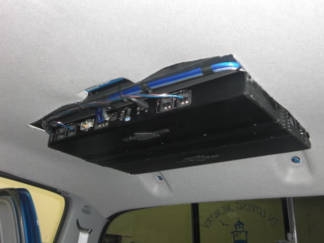

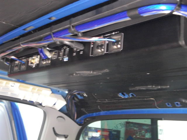

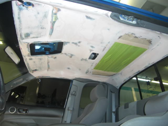

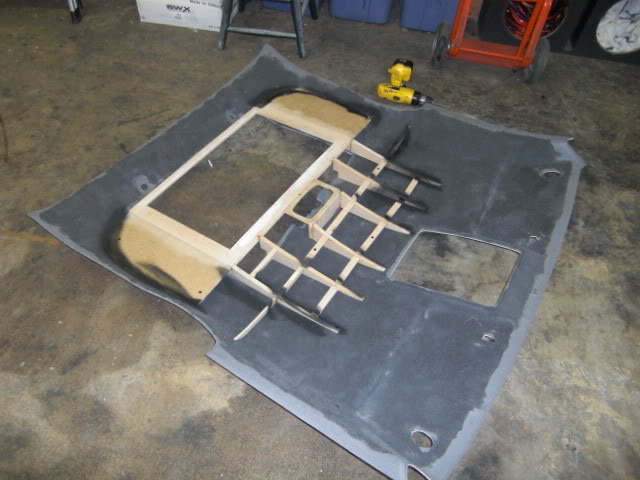

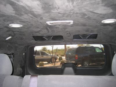

Yeah the ceiling idea I'm not going to go with. Your right about all the weight. Its 48 pounds and that will take someones head off if it ever gets loose.
Or does anyone have any better diagrams of the seat assembly to see if its even possible.
My question is has anyone ever seen it in the Yukon family of trucks done.
---------- Post added at 02:12 PM ---------- Previous post was at 02:04 PM ----------

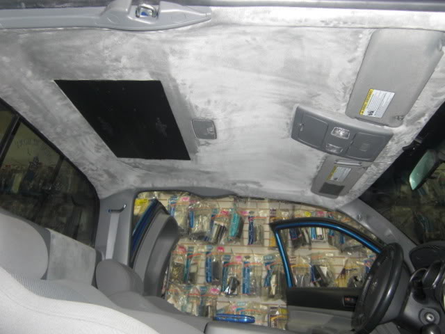

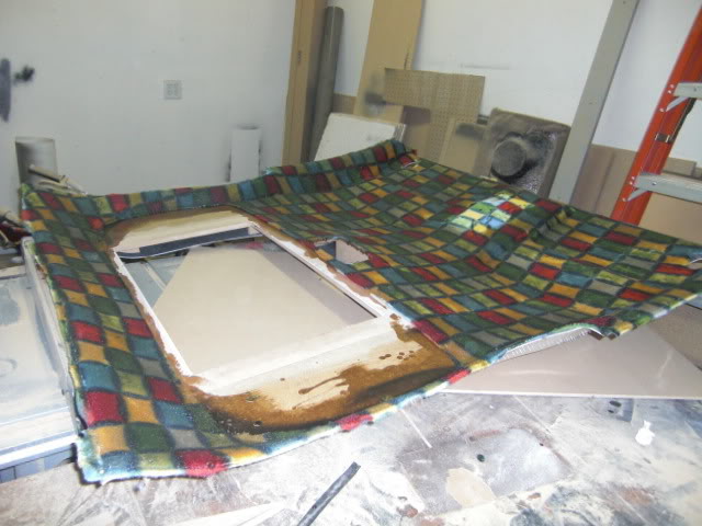

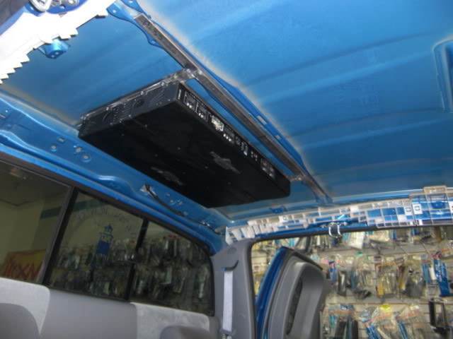

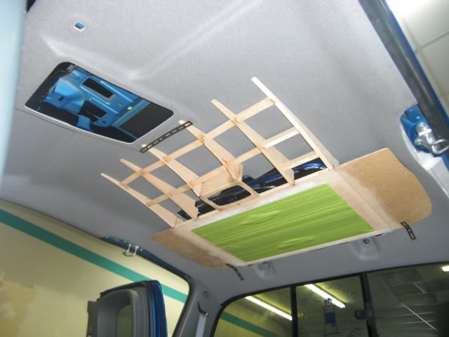

These are the pictures that gave me the ceiling idea. Just wanted to share them.

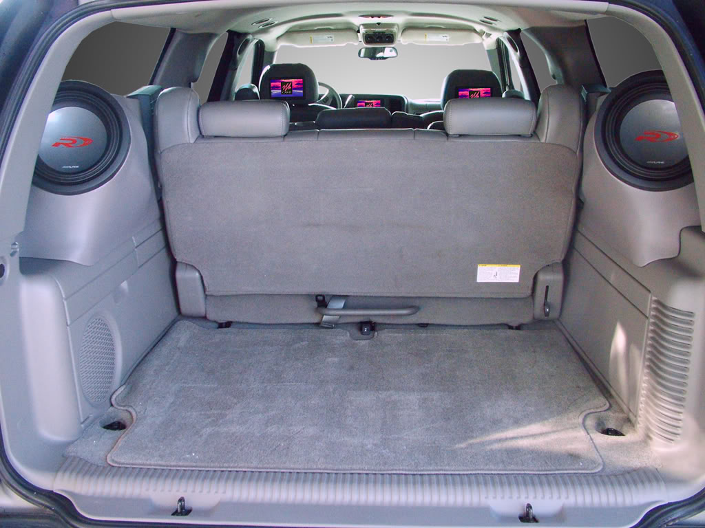

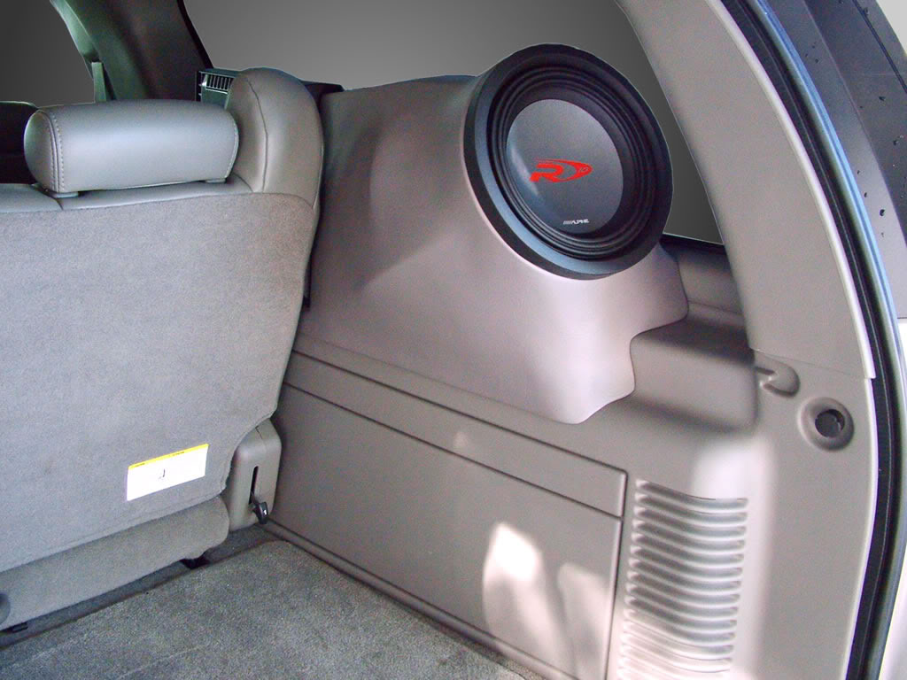

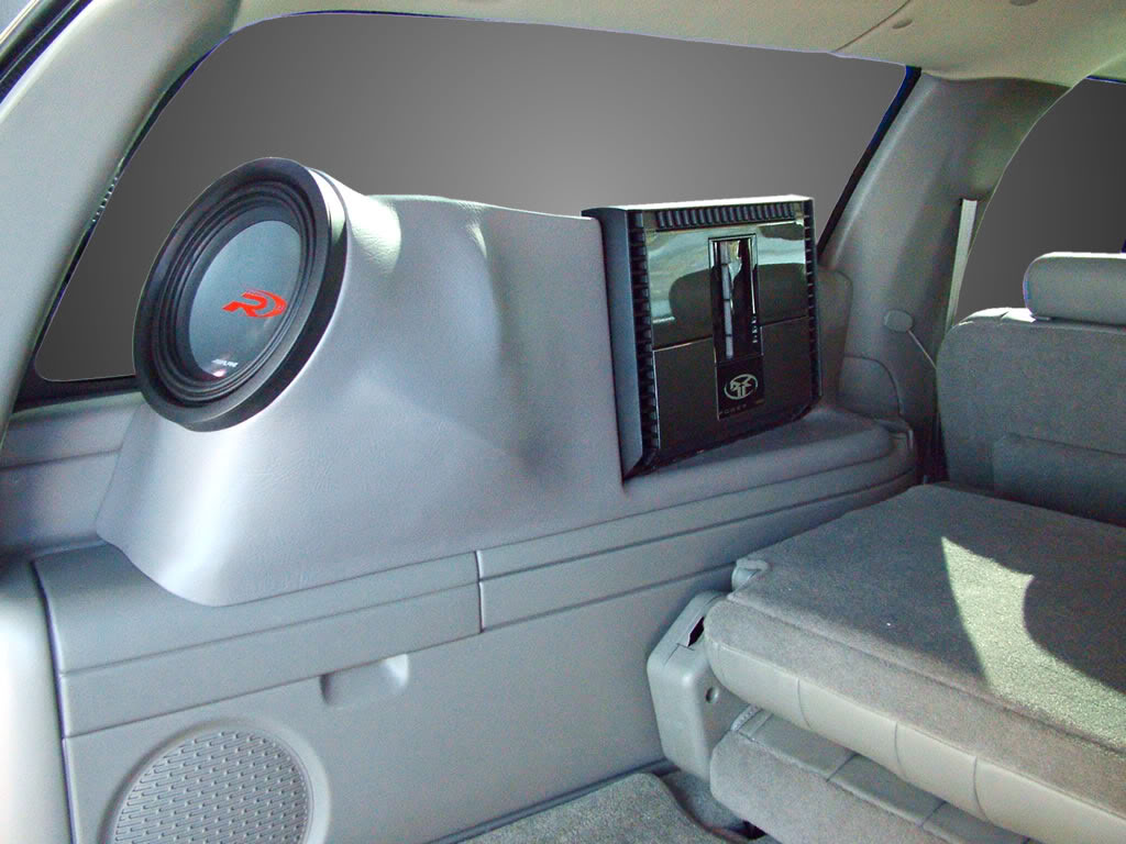

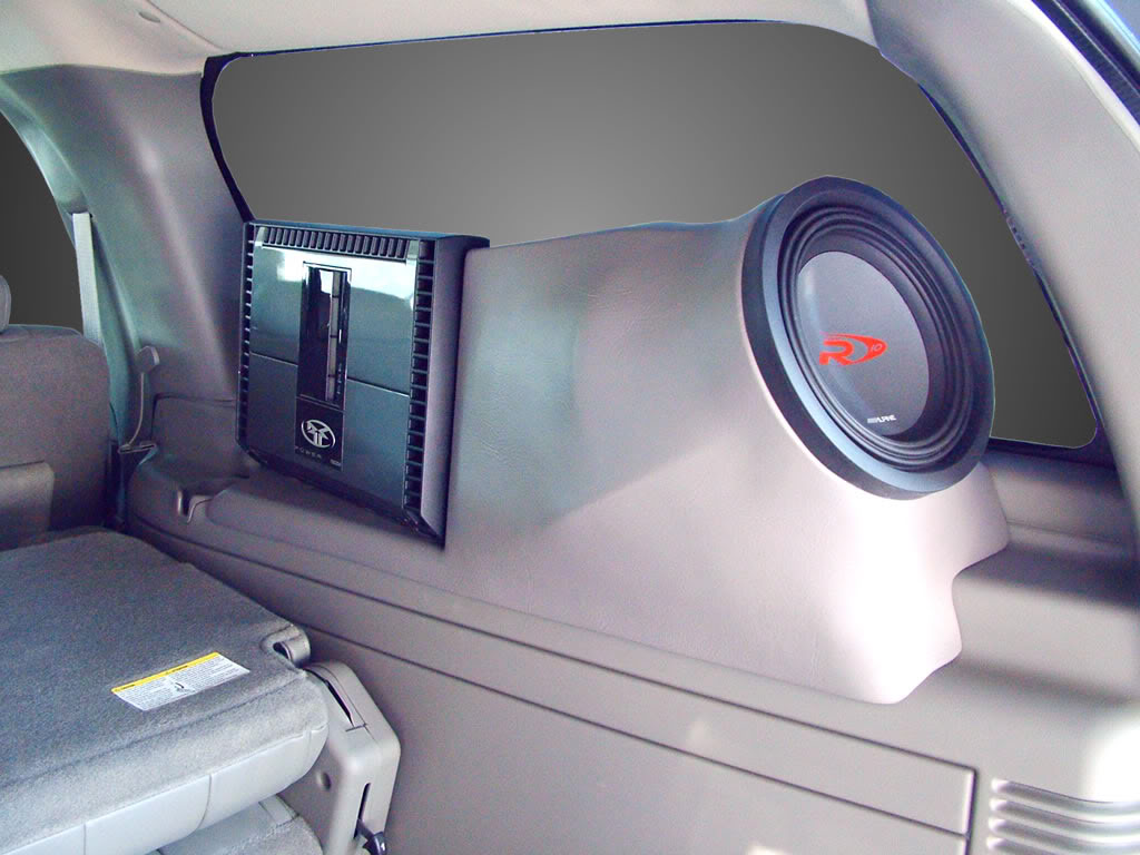

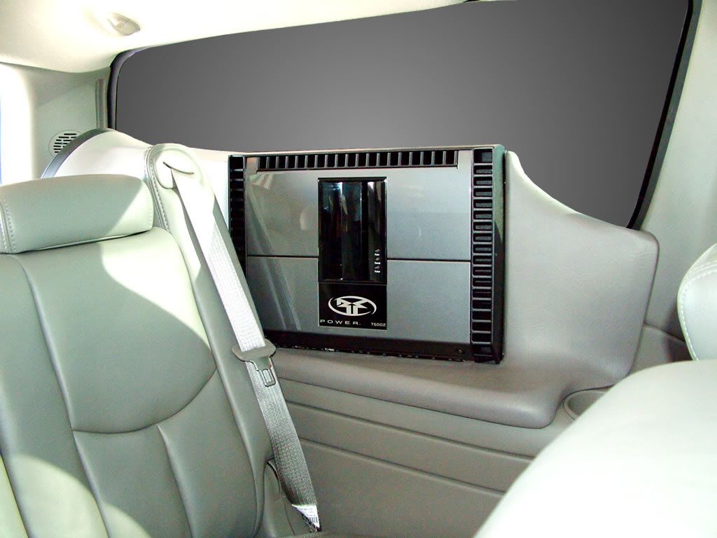

And here is the idea of the window mount but without those subs in my case.

I would avoid the rear hatch. I considered that too but I think it'll put too much stress on the lift gate actuators unless you have a manual lift gate. I think the window option in the 3rd row is your best option.

The amp that you are running is big, I know that because I have it in my Yukon Xl. I'm not to sure if yours is an XL or not but if you are only finding space for the T40001bd then it shouldn't matter. Put it on the floor behind your third row then make a false floor on top of the amp with supports (2x4) underneath and dress it up by routing a center section and put a grille on it and carpet it. This way you get air flowing throught the amp and you display it also. Also this way you still can have your space for your third row to come down when needed and you can put heavy weight on it because of the supports underneath that way it doesn't crush the amp. I'll try to go home today and put a pic of what I mean of mine. Just an idea that has worked out for me all this time and will never change it because it works for me.
