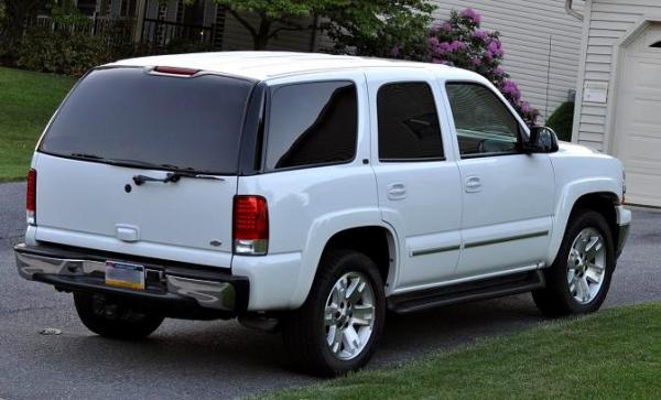

jimweis
May 26, 2009
140
41
Lancaster, PA
Hey guys. Those of you who have removed your roof rack, how have you handled the threaded fittings that stick out of the roof (and of course the resulting hole)?
-B
I put adhesive body side molding on, I had to hollow out the underside of the molding where it went over the insert.

Jim - that looks great. I'm gonna copy you. Oh also, like your wheels and tails - looks like we have similar tastes. :)
