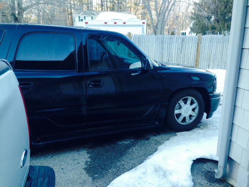

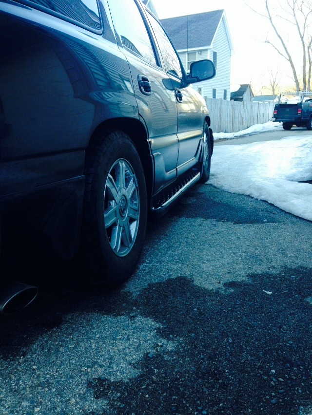

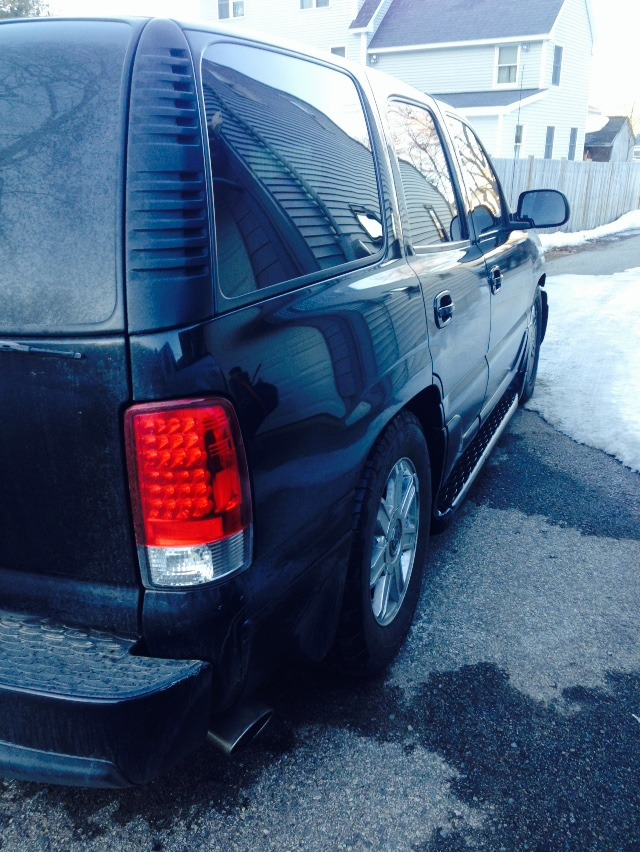

Well i got my 18's on with 265 65 18's. Wow what a ride difference. Soft and handles bumps even better. You can just feel the sidewall compared to my 22's and i kind of like the rims. The turning rubbing issues are better i can turn better, only rubbed backing up turning hard. I havent hit the fender well on bumps i did before but big dips it still hits inner fender well but not as bad. Still need to address tubing the front. For now im gonna run the 18's as i want to powder coat my 22's. Added a few more pics nothing great tho.
Snapped some quick pics today its dirty and look past my dip pealing.
[IM48981B39-30D5-42D2-BB00-C46C6953972C_zpssyl4kjsa.jpgG]http://i874.photobucket.com/albums/ab310/Bomba02/02%20denali/6E8F5259-BFC4-4FC6-AF9A-8994FB0E50B9_zpsrrwjiht3.jpg[/IMG]

Added a few pics nothing special very dirty and dip is pealing on my rims. :wtf:
