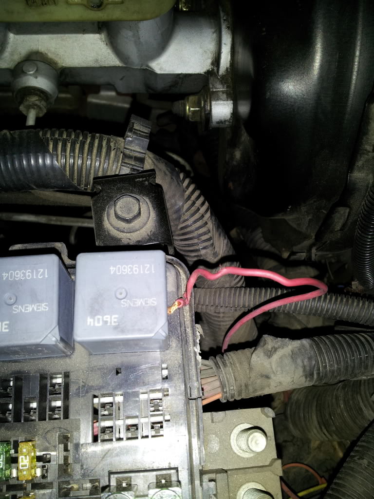

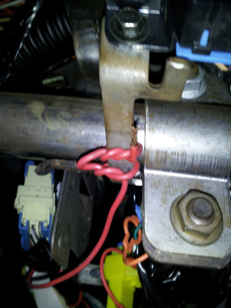

Mine does the same (have not done the door lock deal) and I have not sat down and gone through as to why. I do believe that it has to do with the factory security which can be disabled with tune software, am I correct Sun?
Anyways, mine was like this when I bought my truck and the PO had run a wire from the relay under hood to a metal brace under the dash which I hold while turning the key, letting go when truck starts. I'm am not saying best way, just how mine is started.
