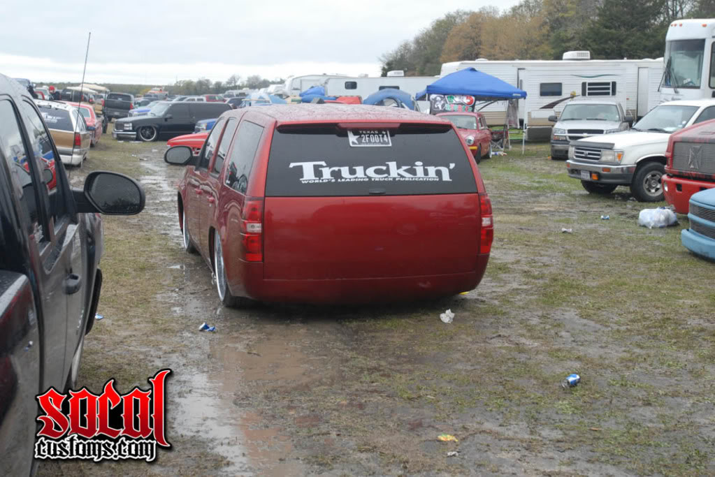

Here is a little teaser of what i've been up to.
First I rewired the lift gate acuator to the pop lift glass switch so I could shave the handle. Then I also had a body shop guy shave the wiper arm while I was at it. Figured I would shave both because all I have seen is shaved wipers on the NNBS. The way I wired it the lift glass still pops with the key fob.
Only one pic for now because it has to go back to the shop to get repainted since there is a bubble in the paint. And yeah I know its dirty.:hands:

Looks nice dude:waytogo:
Couple questions...
1. Do you plan on eventually shaving the appliqué?
2. When you shaved the wiper did you remove all the wiring and motor too?

looks good. Thought about getting my wiper shaved also. Never use it.

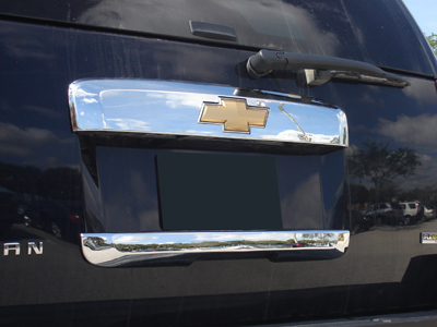

I got a question also, where is the handle for those, i thought they were under that applique thing above the plate?
Regardless looks good.
handle is the shiny chrome thing on the bottom

Also....what did you do about the wiper switch on the inside?

ohhhh i thought that was a just a gm thing to go w/ the top one.. lol..
thanks
50,351
17,144
:lol: GM would NEVER do that!!!! :D

That looks really good M ... love that look.
Interesting side note upon noticing the little handle on the back window ... I never realized you guys were able to open the rear window separately. The Hybrid is one piece aluminum hatch to which the back window is sealed. Yet another subtle difference .. and as it happens rather fortuitous as I also would have to shave it. :)
ETA: Your topic tittle was misleading. :)
