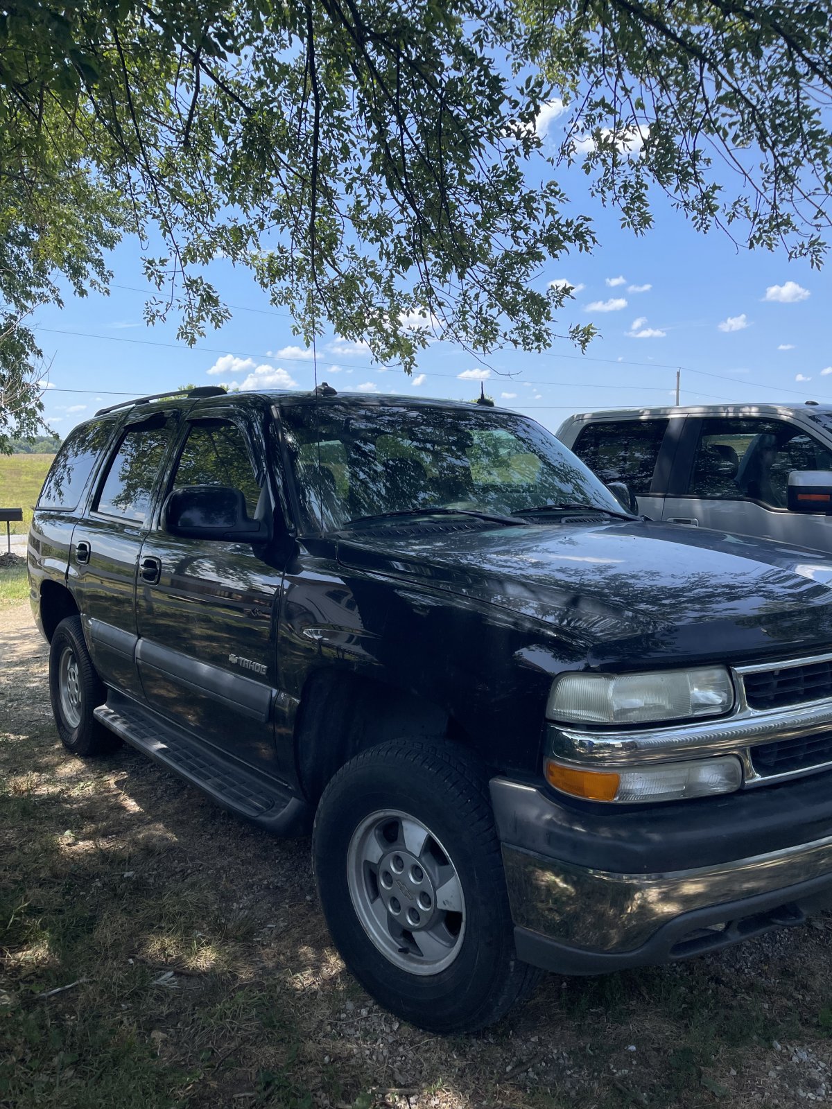

Pics of the truck, please.

I’ll try and get some pics up in a bit

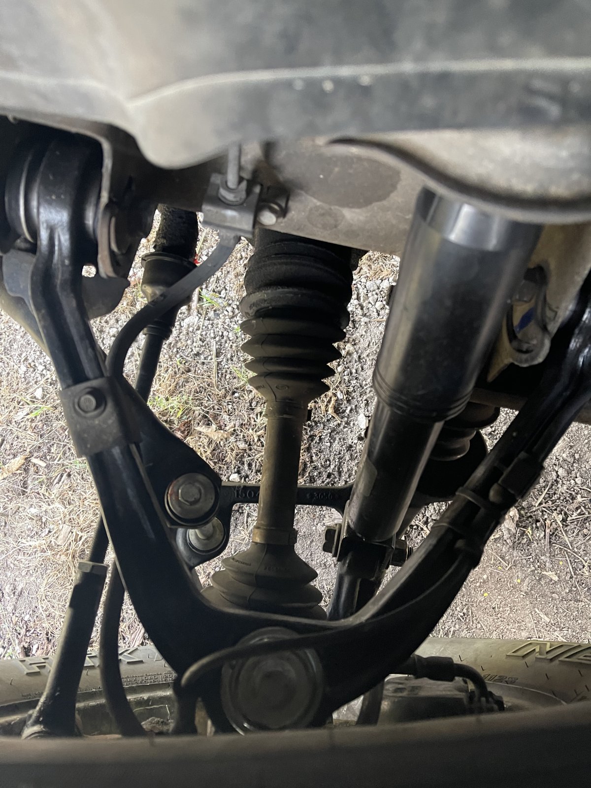

Could you share the year of the rig? I would be curious about the ride height and please share a pic of the before and after alignment readings. I would be curious about the caster readings. Since you have the same problem after all the steering and suspension work, I can't find blame with the quality of the parts, YET! "Front end new" means only suspension or steering components or both. Was it in fact, "entire" front end?

Front wheel bearings? Tie rod ends? Sway bar links? Have you replaced those also? I saw an old Blazer with the bolt on the steering box throw arm just about to fall out of the tie rod link. Look at that as well.

I am going to take you literally when you say 20 year old rig and say you have a 2002. Inspect the steering gear mount as well for any cracks at the frame. @GMCnewbee is also curious about just how much work was done on the front end and what parts were replaced.
