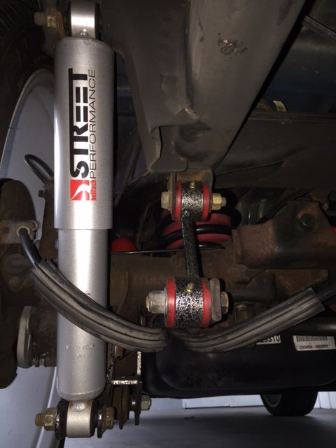

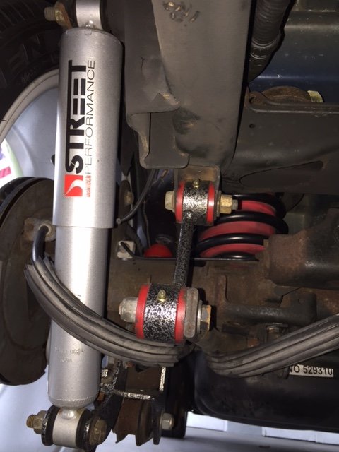

Can someone please post a pic of the shock extenders installed? I think that the guy I had do the suspension work didn't use them the right way.

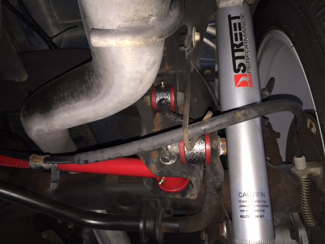

I have 2 s shaped end links. Is it supposed to be one straight and one s shaped ?ImageUploadedByTapatalk1465673443.895218.jpg

Interesting. Here is my setup. Looks like one straight and one s-shaped.
Left rear.
Right rear

are you talking about the shock extenders or swaybar endlinks.

Curved goes to pass side. Drill 2 holes to move sway bar over
