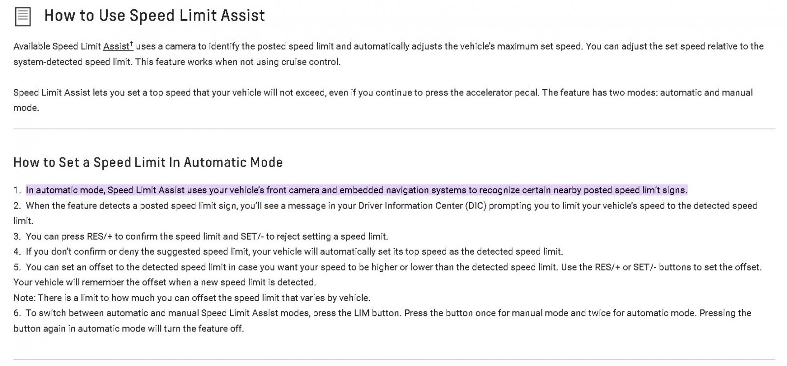

I was not aware this was a feature but this is what it says

Thanks Wes, I didn’t know that was a thing either. What I’m hunting for is called traffic sign recognition. On the driver display and heads up display there’s an image of a speed limit sign that’s supposed to display the last sign the camera saw. My display shows the signs, they’re just blank white squares. I’m going to try that other feature tomorrow.

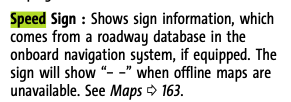

As far as I know, the "Speed Limit" sign in the Displays (Instrument Panel Cluster and HUD) uses the speed limit info from the Google Maps it downloads. If you have no Data Plan for your vehicle, you have no speed data.
Pretty sure this is how it works, because whenever my system is updating offline maps, the speed limit sign shows "--"
If you have no data paln, and get sick of seeing "--" you can turn off the speed limit display in the options for the Instrument Panel.
Here is a snip from owners manual:

Thanks. My OnStar module is down and the dealer is waiting for a new one. That’s the first I’ve heard of a possible data plan issue. I’ve seen everything from it coming from the front camera, google maps, or a combination of the 2. When OnStar is fixed I’ll report back.
