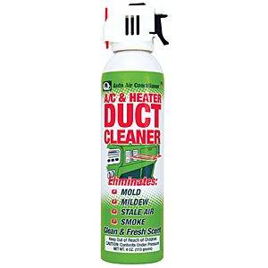

buy a can of ozium....turn on vents full blast. Crack windows. spray ozium LIBERALLY into intake ducts in front of windshield by wiper blades.
enjoy clean air from vents
I recommend doing this weekly until the quality of air suits you. Then repeat monthly.
this also gets rid of mold, mildew, smoke smells and stale air stench
Where can I get a can of that stuff from?

ozium will work, but they make a disinfectant spray just for this situation. i forget the name of it, but explain it at the parts store and im sure they can point you in right direction. but as mentioned, your air system pulls its air from the base of your windshield, on the outside of vehicle. i never had to do this on my yukon so not 100% which side of truck the vent is on, but look around, im sure youll find it. you may have to pop the hood, im not sure. but turn your ac on full blast and spray the stuff in until its entering the vehicle(youll smell it, smells kinda like baby powder) and youre satisfied. then turn the ac off and let the stuff sit in there for a little while. repeat as needed.

I will also look into the ozium or anything related my parts man suggests. Get some in there after cleaning out the heater core should be a real finish.
