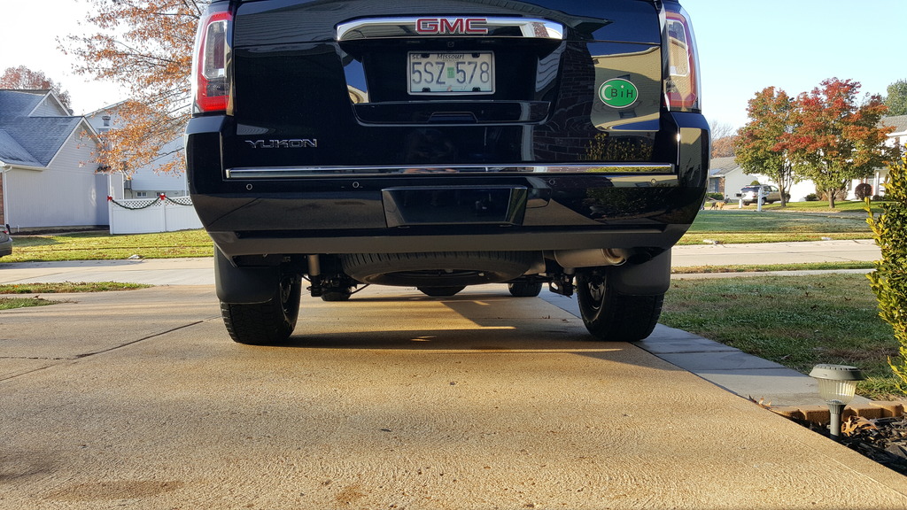

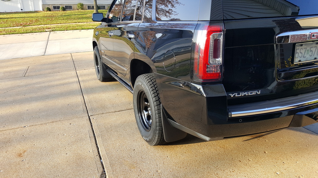

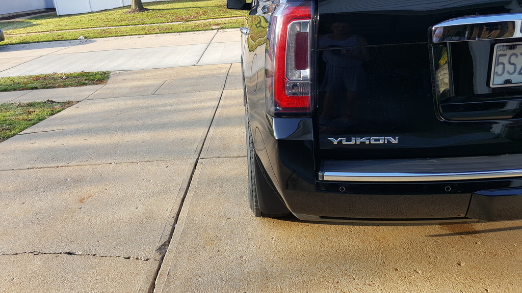

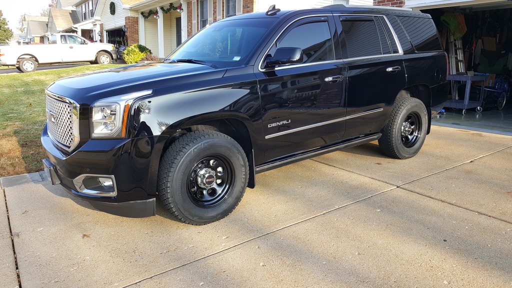

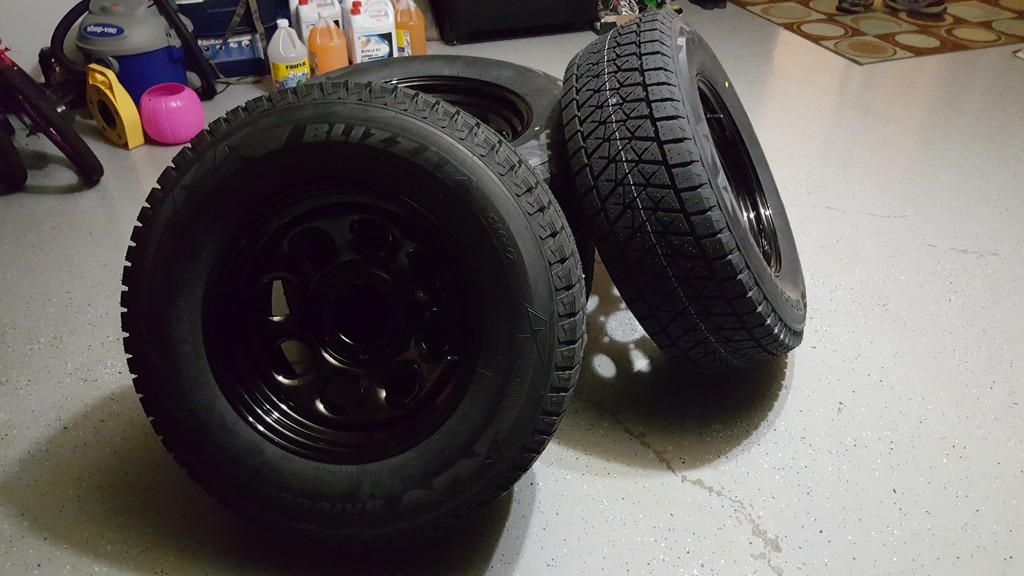

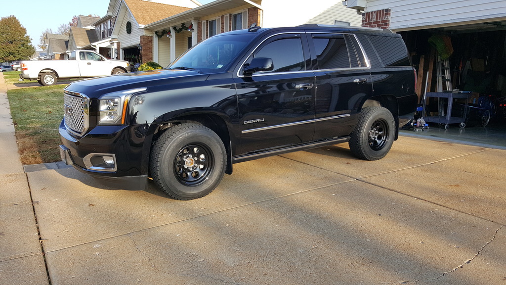

17x8 Cragar Soft 8 4.5" backspacing and 0 offset part # 3978860 They fit just fine. There is enough clearance to clear caliper. I installed Bridgestone Blizzak DM-V2 265/70/17 like i had on 07 Tahoe LTZ
I did order Cragar center caps 4.250 part # 29271-1 but i didnt like them because they are too tall and they have some play when installed on Cragar wheels. So i got some chrome Sierra center caps part # 20941992 that comes on 05-16 17" painted or chrome skinned wheels and lug nuts with external threads part # 9595175
I did this because i like my OEM 22" chrome multi spoke wheels and didnt want to ruin them with salt, plus wife is gonna drive it over the winter and dont wanna get any phone calls that she is stuck in snow with her 09 Altima. Im profesisonal truck driver and If it was for me and if i didnt care about stock 22s i would drive in RWD mode with 22s all winter long but didnt wann take chance because wife is gonna drive it
Here is a few pics without and with GMC center caps, also these is pocs of Cragar chrome center caps
