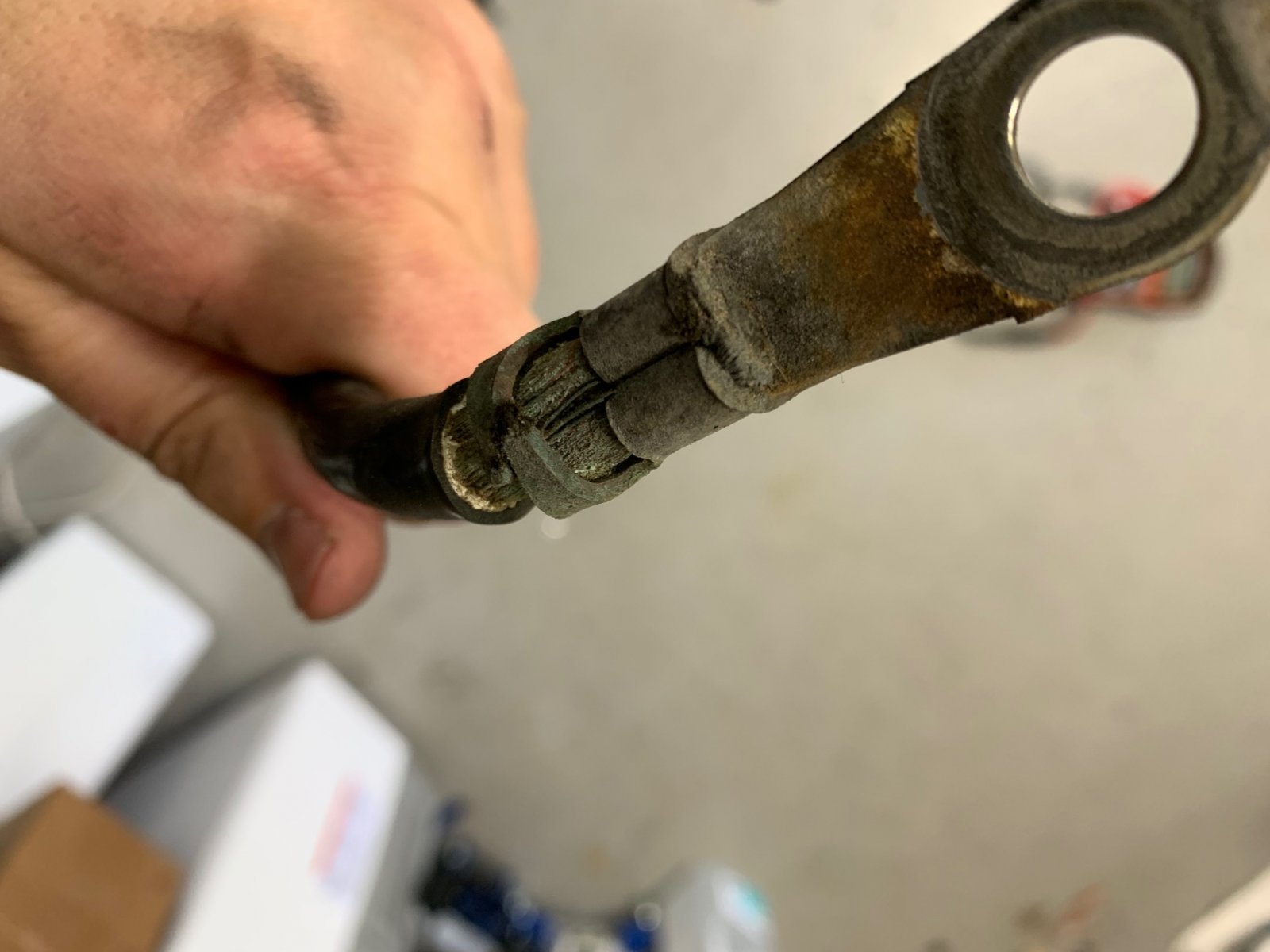

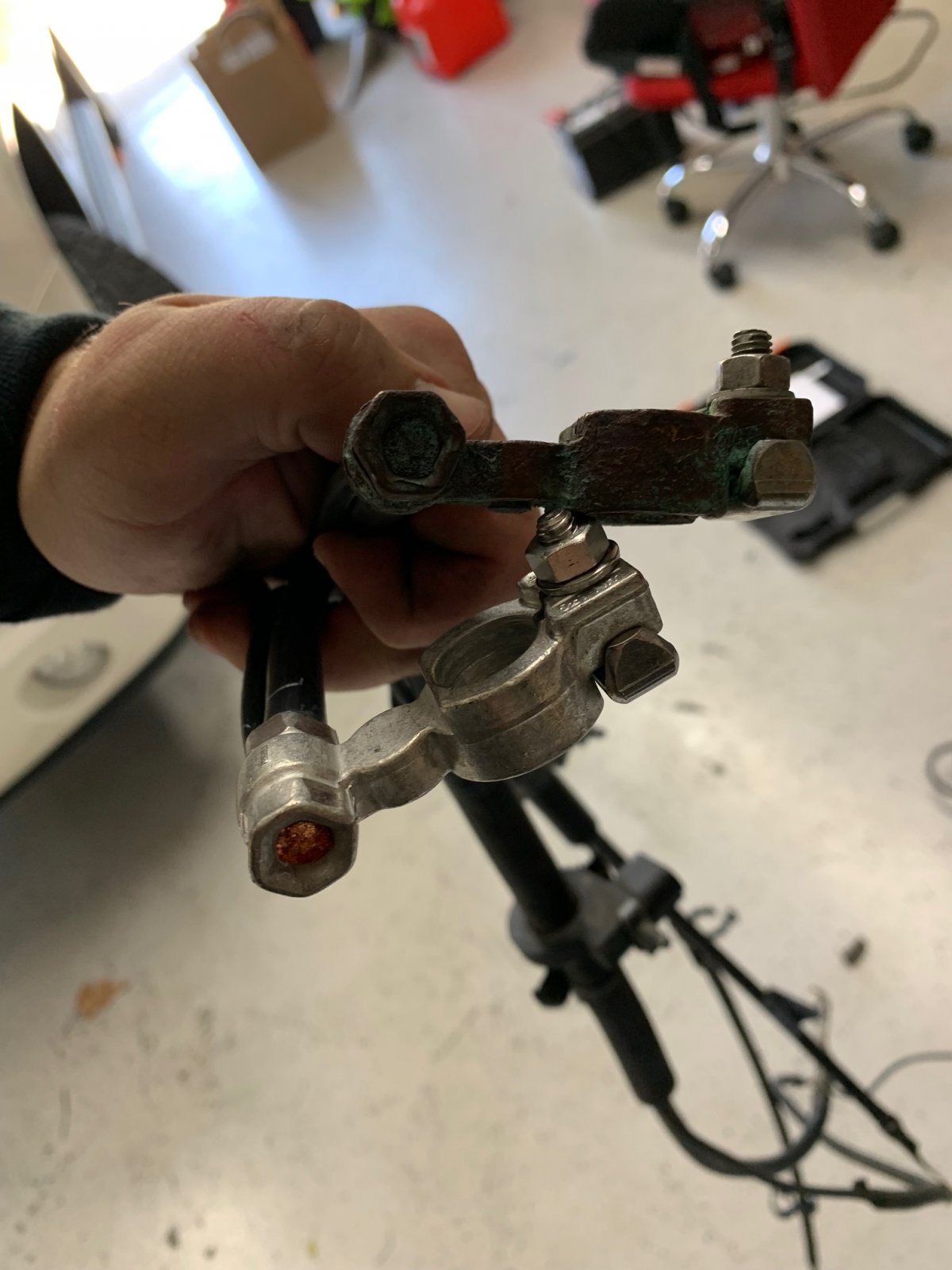

Wanted to post this as a possible solution for others, if you notice corrosion, I'd start with a new negative cable and 45 min in the garage before throwing $$$$ at diagnostics and control modules. (I will qualify, if you're getting DTCs in the module it may be more than just voltage drop. You may want to start looking there for frayed wiring/loose harness connections as GM had quite a few service bulletins. Sounds like that may also be a common problem).
I've attached some pics of the corroded cable and one compared to the new cable. I'm betting there was definitely some voltage drop because of the corrosion causing my 'ghosts'.
