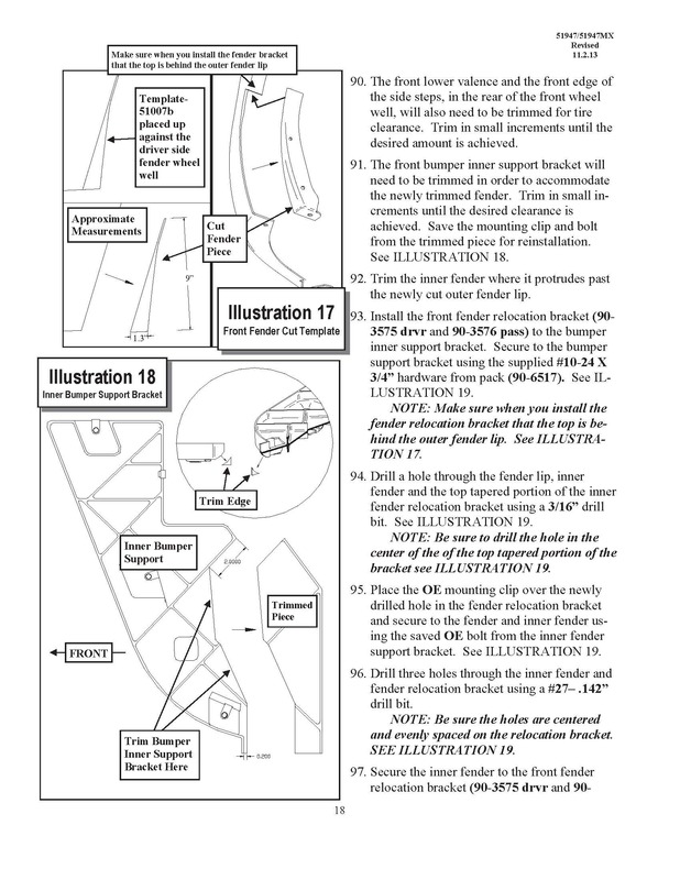

So I am about to buy some new tires
right now I have a rough country 2.5 front and .75 rear
I think i am going with a 275-60-20
is this the way to go or can I do something minor to go up in size
01Konvict
Boats n Hoes
Jan 16, 2011
2,740
691
Raleigh/SML
Only seen 3" on these NNBS which looks like crap to me. I prefer a 1.5" BL helps hide the frame. Those tires will clear though on a level kit and cheapest largest class C tire

if I pushed it to a 285-60-20 would it fit at all
would adding spacers do anything
