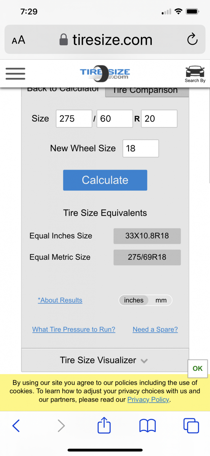

Here’s what the tire calculator says. Since you’re keeping the same size, or close, you should be fine fitting the spare. 1695123111626.png
