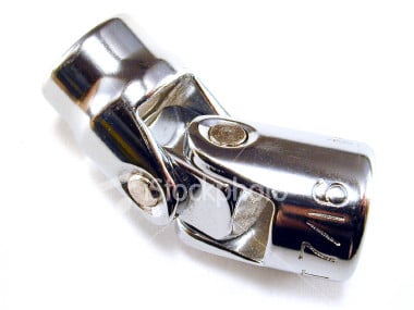

its not hard replacing the plugs with swivels and extensions. go with delco 41-110 plugs
its tricky removing the spark plug on the passenger side near the firewall
