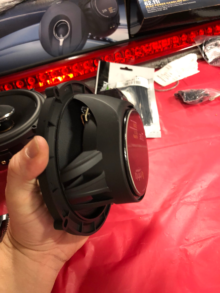

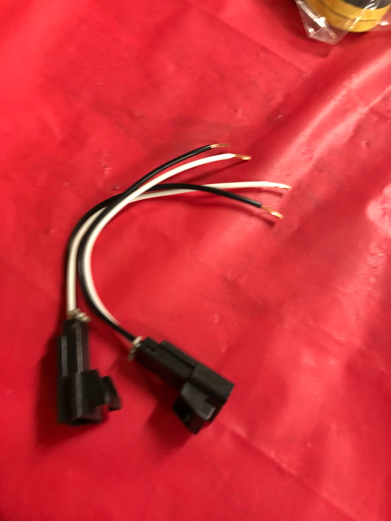

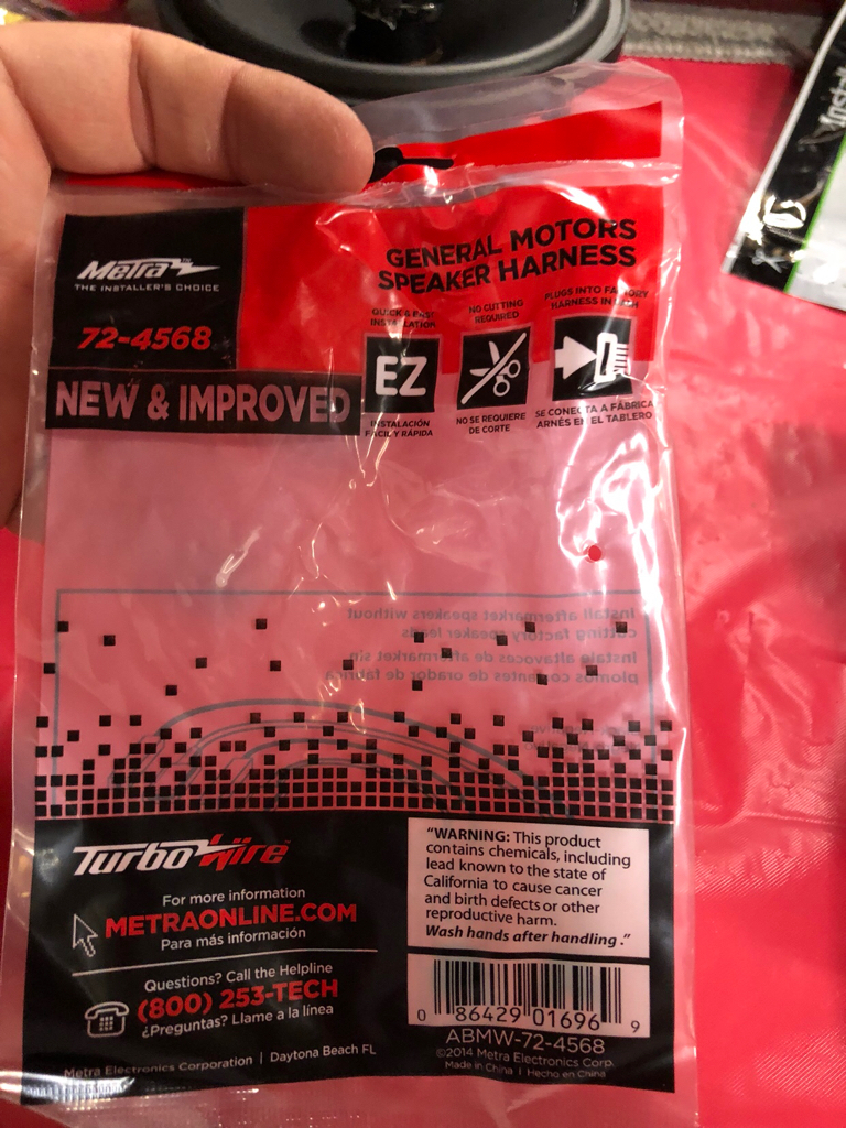

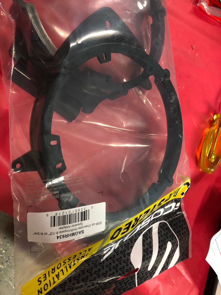

I’ve seen a special on the kappas from an online store that gives you all the install gear for free. They are based out of Virginia. Don’t want to name and get in trouble for advertising. Lol I just ordered for my Yukon though
