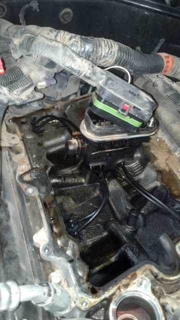

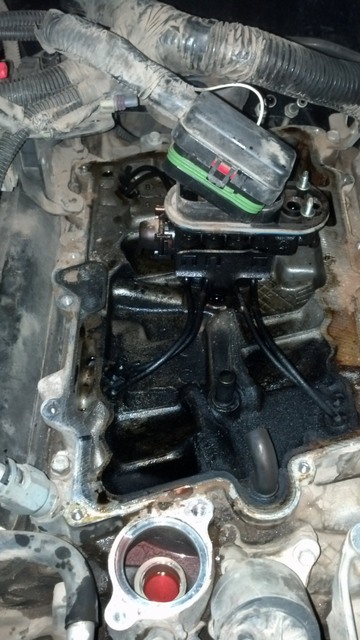

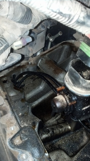

I'm in the process of replacing the LIM gasket, and got to the point where the upper intake is off. When I got it off I noticed that there is a lot of soot near the front inlets, but the rear looks fairly clean. Is this indicative of a leaking/bad spider injection system? Or is this fairly normal?

That crap is from the EGR system. Normal.
You can see the egr pipe poking through
