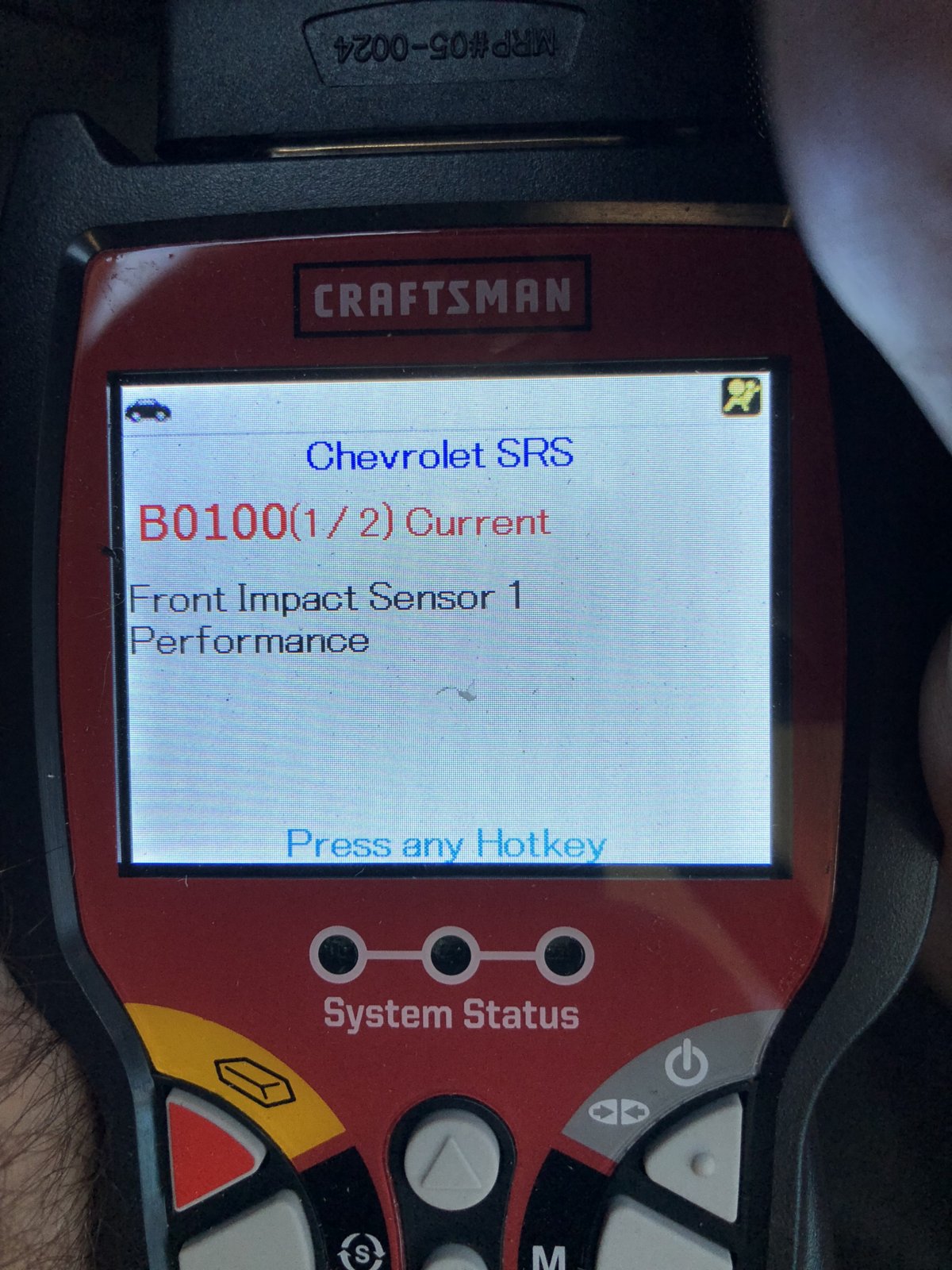

I check seat connections (no airbag in seats) and use my scanner and get a B0100 code (front impact sensor performance).
I ordered new dorman sensors and replaced both front sensors and after clearing the code the airbag light comes on. So I removed the new sensors and put the old ones back in (swapping left and right) and get the same code.
Any ideas?

The other code is the same.

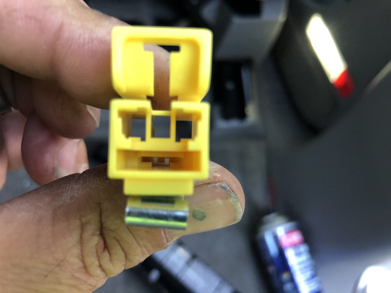

Just went under the seats. The yellow airbag connectors there are nothing!
I unplugged the airbag brain last weekend and cleaned it also.
Any more ideas?
