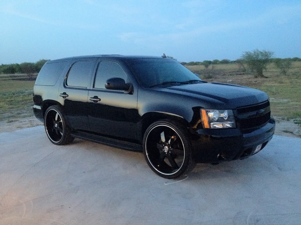

I recently was able to finally put my drop on and after all was said and done the stabililink light cane on, what could cause that? I used the 2/4 drop from norcal ss with the drop struts in the front. Any help? Here's a pic of her all done
