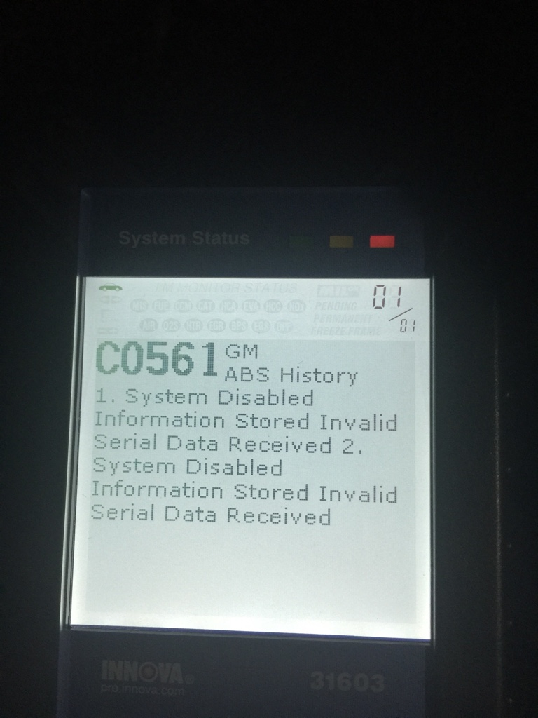

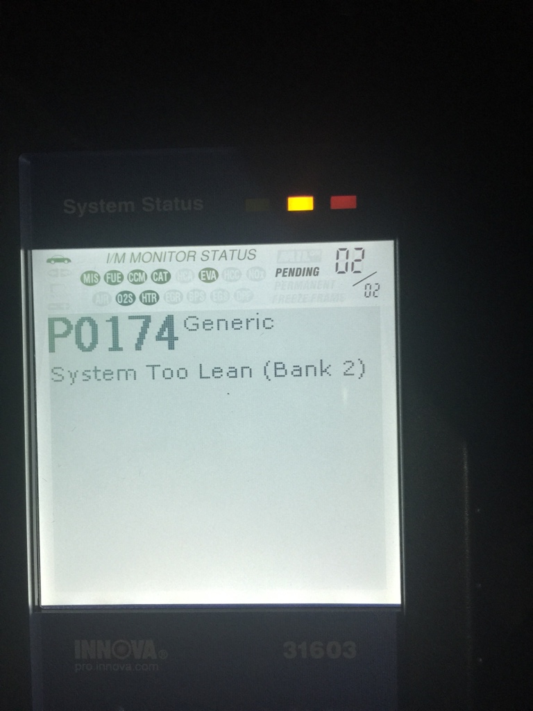

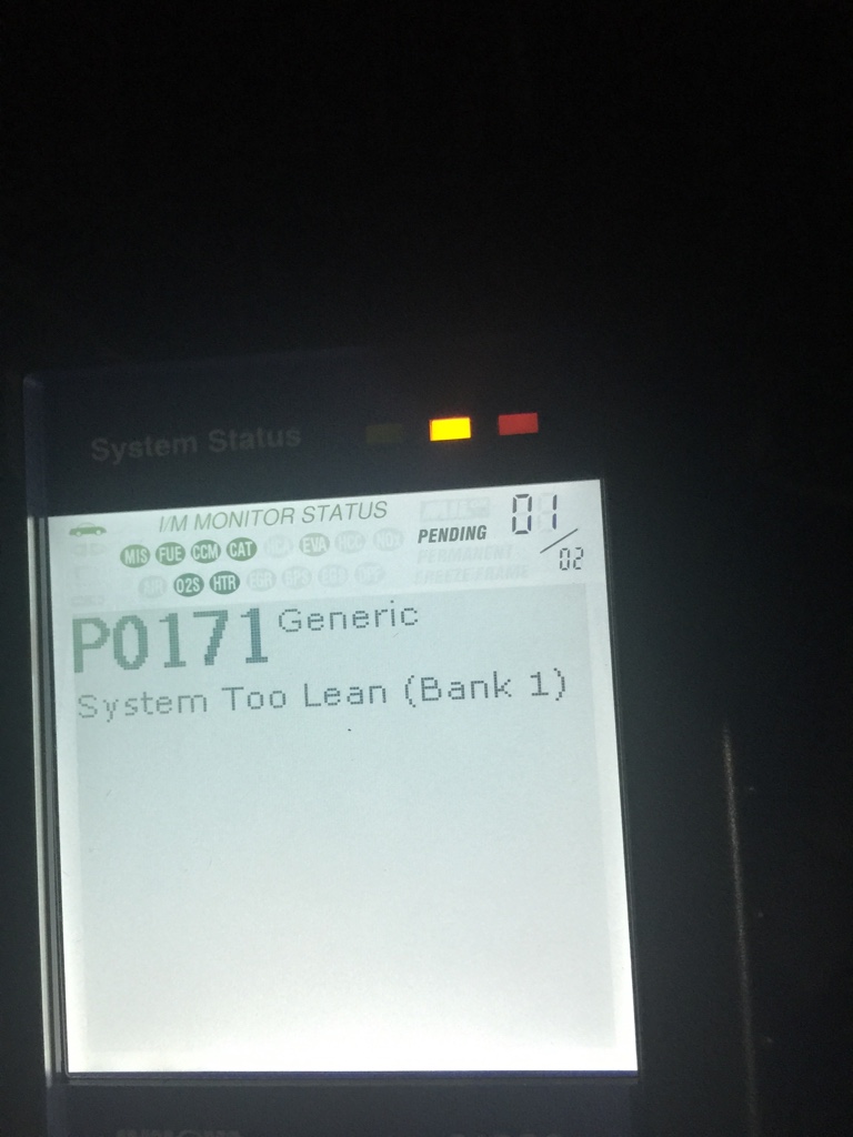

BSarteSr
May 2, 2010
211
46
I had an issue earlier this week with both the Stablitrak and ABS saying needs service. The ABS one indicated an issue with left rear wheel. Took the rod off the left rear control arm sensor, move it up and down a few time, put it back on and I was able to ABS error, not coming back on.
The service Stablitrak message is still showing and the ABS light is on.
No codes!
Not sure where to start looking?
BTW, this is a '07 Yukon XL Denali.
Any help or guidance on where to start would be greatly appreciated.
50,389
17,299
The issue is that, at least for the 07-14 models, that stabilitrak message pops up for darn near any issue you could have with your vehicle. It could be TB related, ABS sensor related, alignment issue, MAF issue,....pretty much anything under the sun (for reasons we are not clear on really). So my suggestion would be to just watch it and wait until the vehicle either starts acting up or a code is thrown. If neither happens start with things like getting your alignment done (and other things that would not throw an error) and see if those things clear it up. Other things to check would be the connections especially if you've recently put new shocks on. There are connections right next to the upper shock bolts on teh back and they are REALLY easy to unplug accidentally throwing this message on your DIC. Ask me how I know :lol:
BSarteSr
May 2, 2010
211
46
I did not do any work on mine, but had the Service Traction Control and ABS messages come up.
I checked the codes, found one for the ABS, really did nothing, but the ABS code cleared, still have the Service Traction Control and ABS lights on my dash, only the Service Traction Control shows in the message box.....
I check the ECM with my scanner, no codes show up. Do I need any special or added functions on my scanner to read the Stablitrak/Traction Control system? Mine has ABS and SRS besides the basics.
Still no idea where to start.
