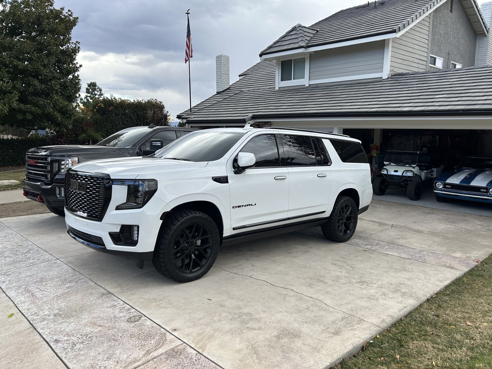

Toyo at3’s in 285/50/22. No rubbing with stock suspension.
