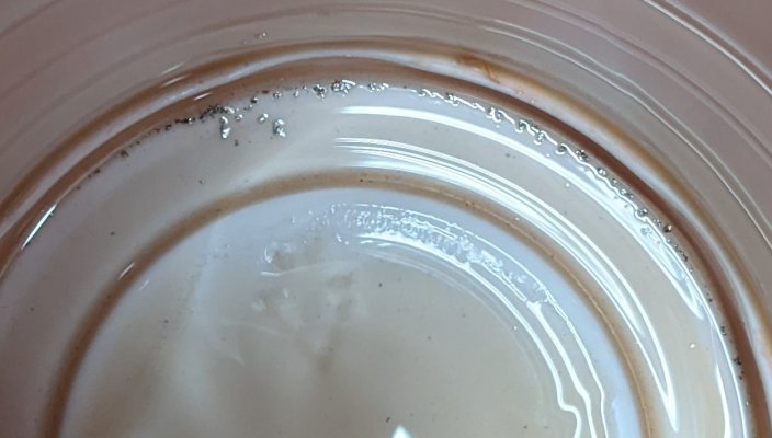

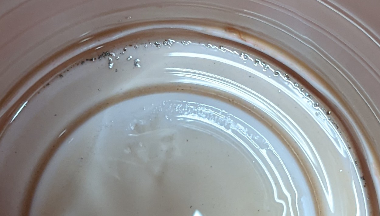

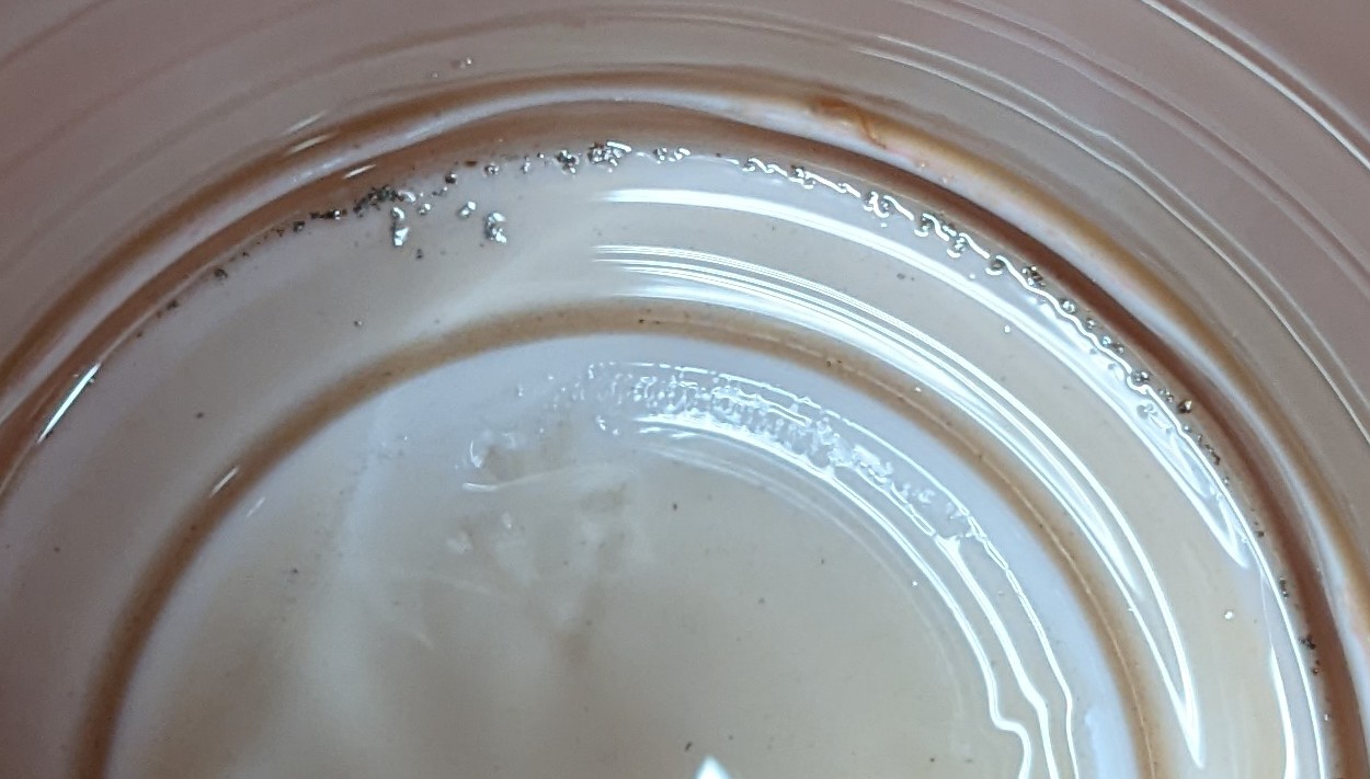

I went after the ignition and intake stuff many folks have done. Nothing helped.
With more research, I settled on the torque converter shudder/ failing TC/ lockup clutch.
I was hoping to just replace the TC, but was concerned that its failing many have shed metal particles. So I connected a hose I use to change fluid to the trans oil cooler and pumped out a cup or so.
Yep, metal in the cup.
So rebuilt trans, TC and are about to happen. Good time to replace that leaking rear main seal as well.
