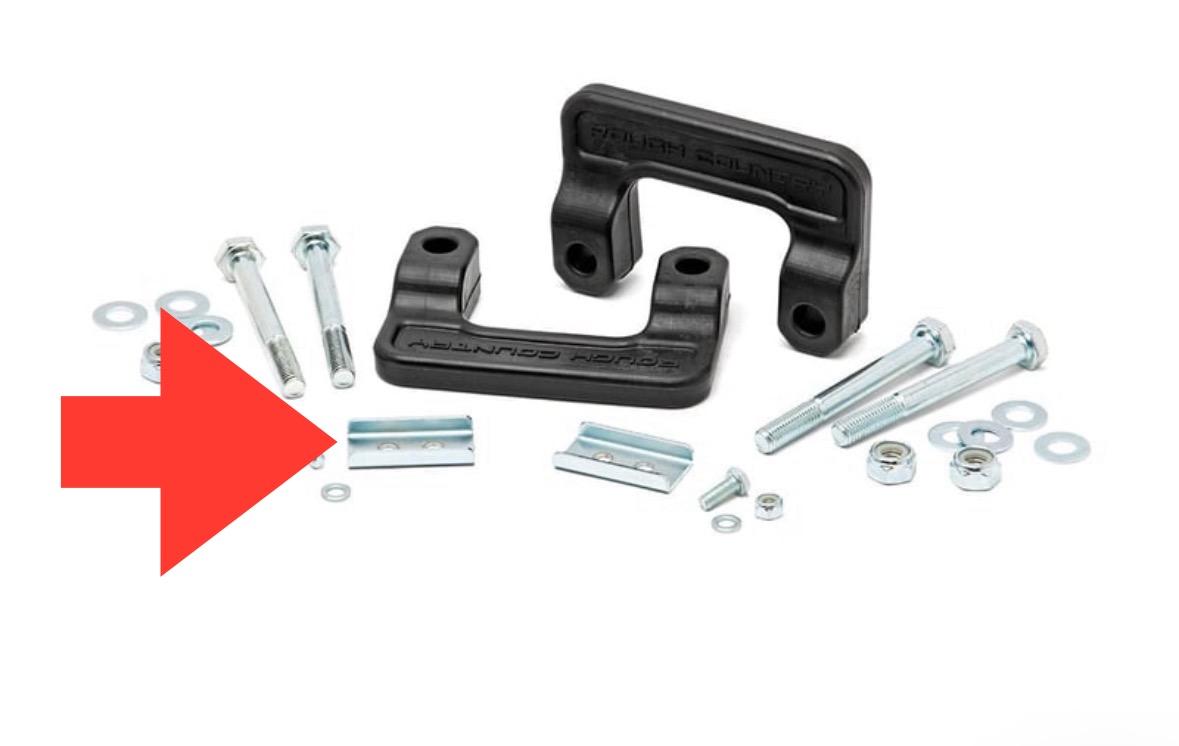

Did you install brackets for the sensors? If not, that will throw a code for sure. There should have been small brackets to drop the sensor arms down so they are in the correct location.

These little brackets here…
