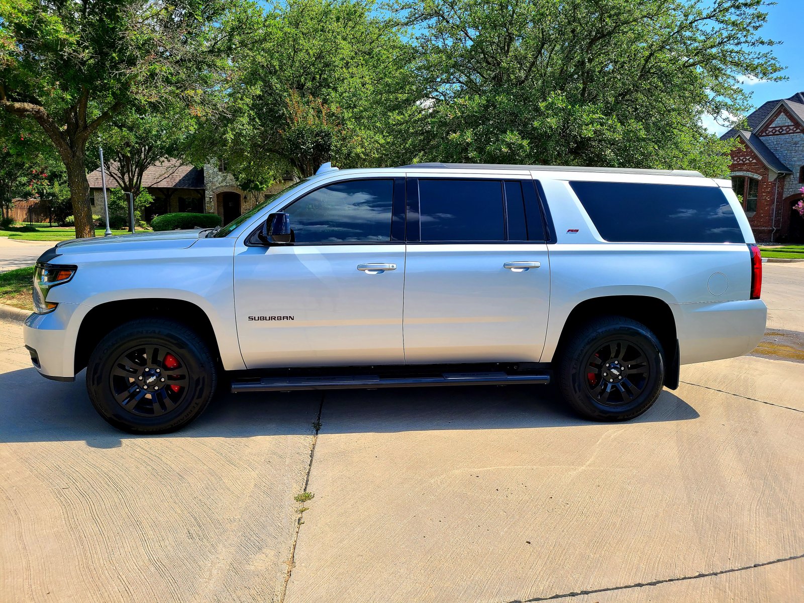

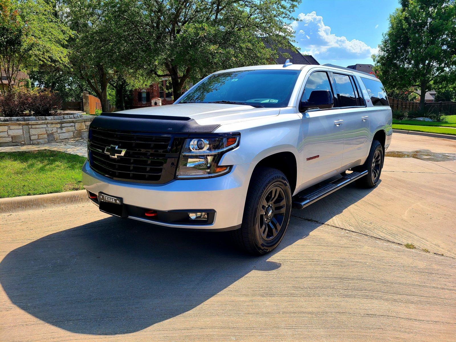

K2 Kaiju
Feb 17, 2015
704
747
The Depths
265/70/18 with a 1.5/.75 mild level on stock LT 18s...
