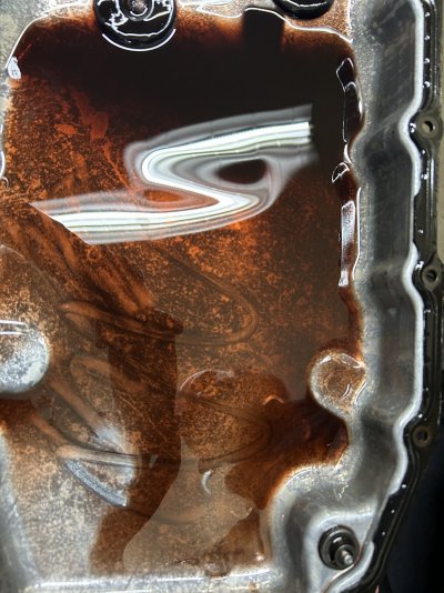

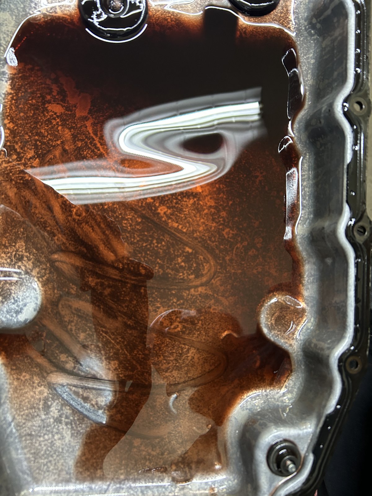

Dealer checked it, but going to have local trans shop pull pan and check. Both say there is newer fluid. shop road-tested vehicle. I'll update. Trans shop

Not the best photo due to shop lights, but doesn't think it's self-destructing. Doing new filter, flush, newest fluid, friction modifier, then drive.
