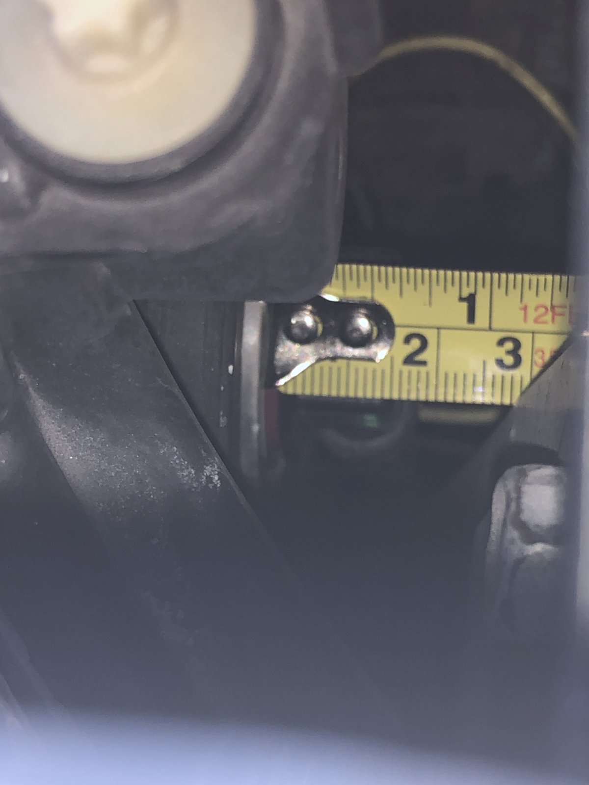

Doesn’t look like the H11 will fit. VLED states their H11 measures 31.5mm (from lip of the flange to the back of the bulb) which is just over 3cm. The distance between the edge of the bulb housing and the bracket is just UNDER 3cm.

I appreciate it. I havent been under the hood to measure the gap. May have to go with another, or just notch that bracket out i guess. Thanks for the info.

No problem. Yeah I ran into this problem a couple weeks ago. Had to return a pair of nice Hikari leds that were “supposed to fit”. When I contacted customer support about it they kept referring me to YouTube links on how to install the lights. I was like, no, I know how to install them they just don’t fit. So after I sent them that picture of the space between the bulb socket and the frame bracket and a picture of their bulb next to a tape measure they were like, uh I guess you’re right. Feel free to return them.

The vanquish auto on here claims that theirs fit. Not sure if they are any good, never heard of them
