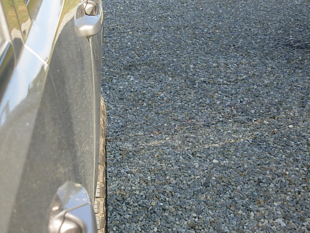

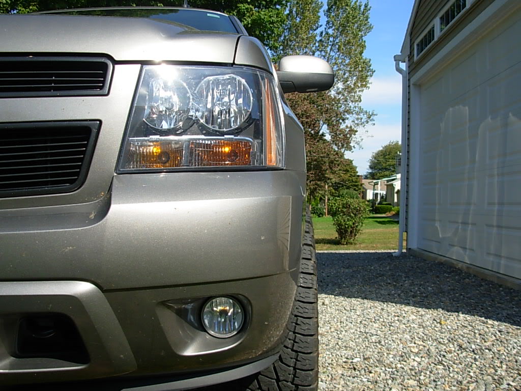

9" wide +18 will sit outside of the front fenders. I have 8.5 wide +23 and they are flush with the top of the front fenders (non Z71)
bigbluebowtie
Nov 16, 2010
38
Minnesota
I will get some photos over the weekend
This wheel combination would end up about another 3/8" outside as compared to mine
