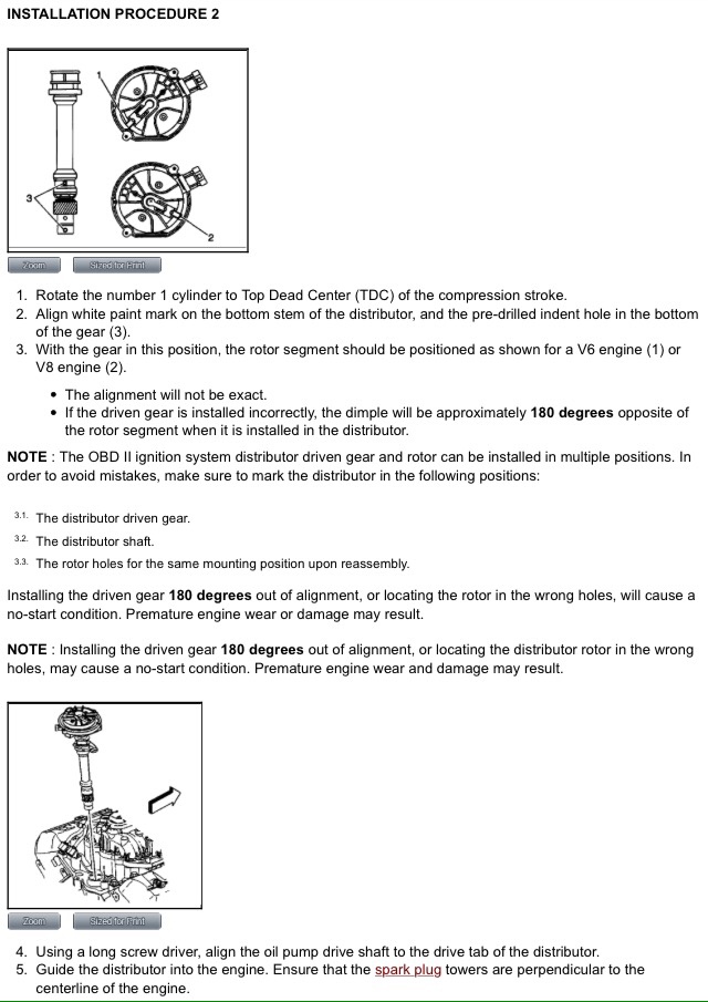

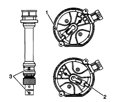

In case you are starting over, here are the installation procedures for the distributor:

thanks I'm going to go recheck everything and make sure it all lined up right n see where its setting with the cap tab.
