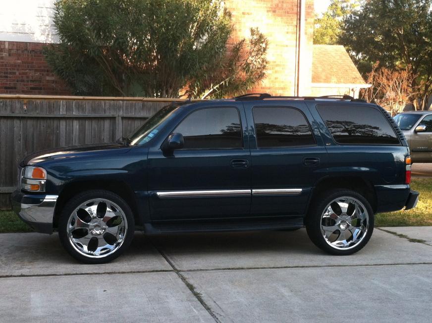

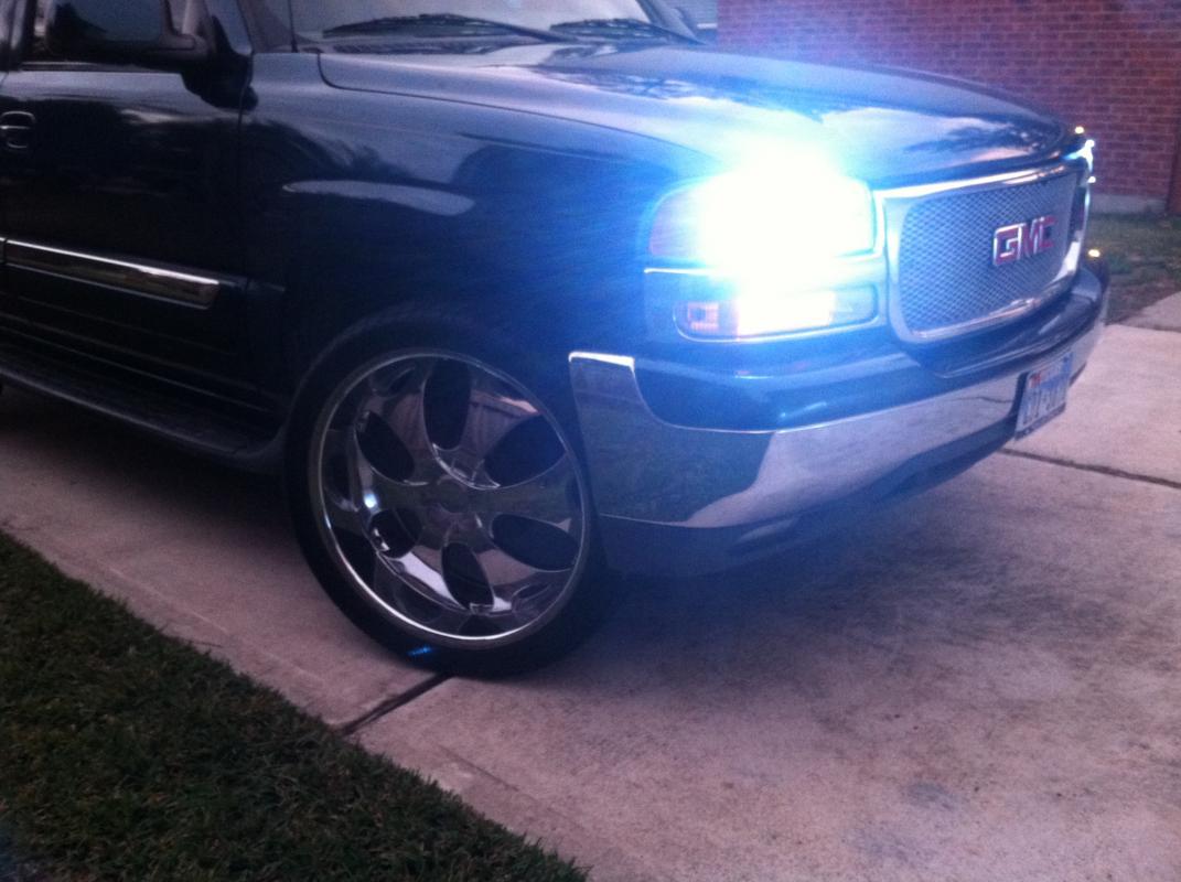

I want to do a affordable drop kit so im looking at a 2/3. What are the pro and cons of using torsion keys over spindels, a arms ect? I have herd of peoples rides tilting one way or another with them.....?
