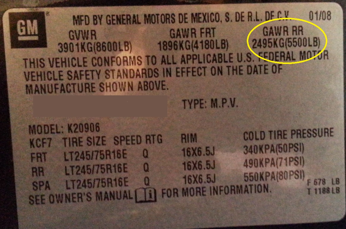

You might want to double-check your payload on the door sticker. I doubt it's 2500. Probably closer to 2000 or 2100. Payload of my 2008 is 2088 lbs.

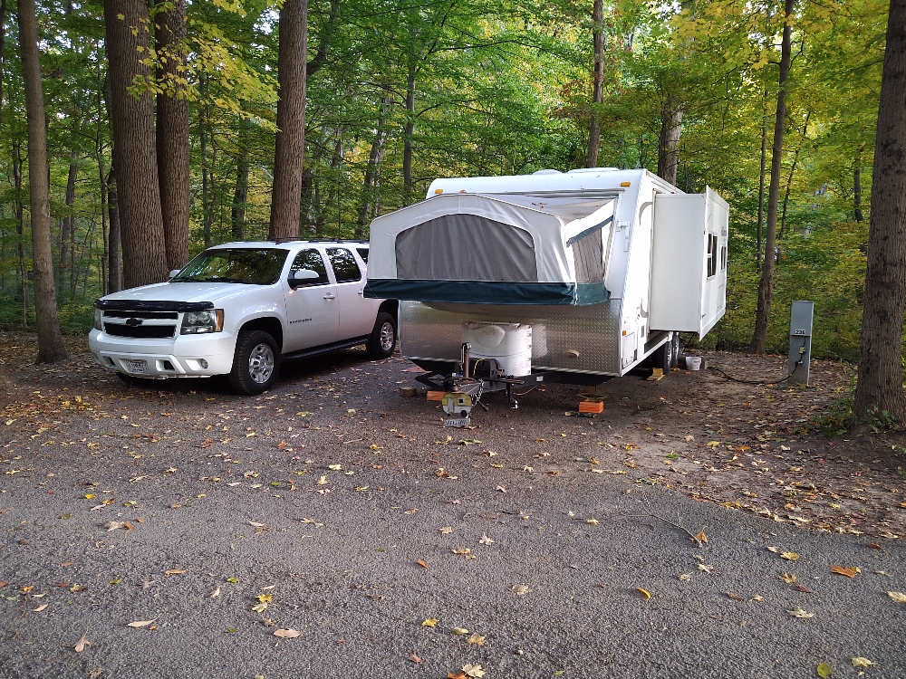

I've towed my 8600-lb trailer all over the country, including some Rocky Mountain passes and the Eisenhower Tunnel. She does just fine. I'm never a menace causing slowdowns behind me, and I'm always faster than the big rigs. The 6.0 loves to rev - let it eat!
Our rig parked at Wall Drug. Notice no WD on the hitch, yet she still sits perfectly level. 1120-lb tongue weight.
