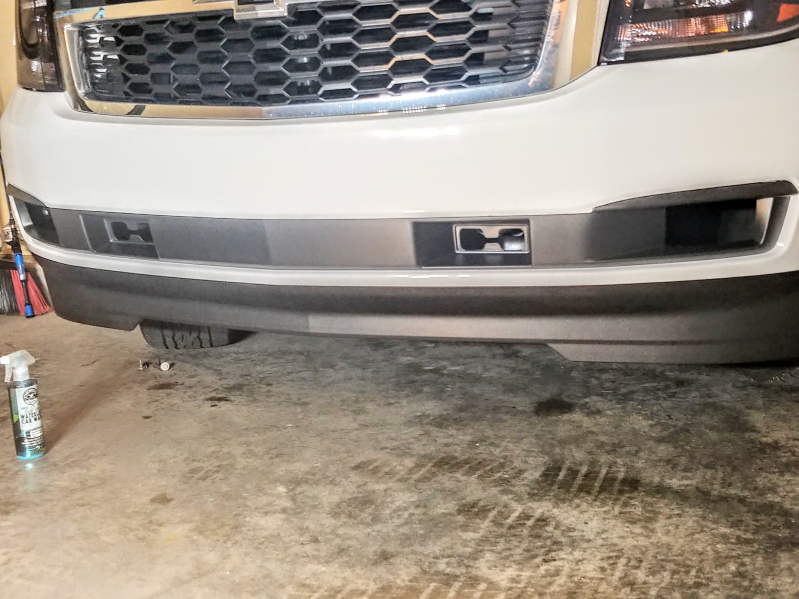

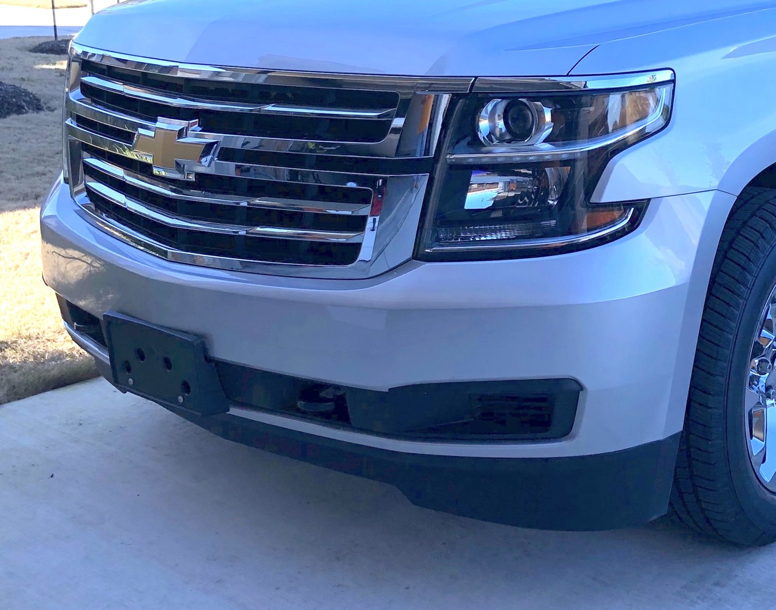

I'm sure this has been covered in previous threads, but wanted to share my experience installing the lower bumper fascia with the tow hook cut outs. My 2018 tahoe did not come with tow hooks or fog lights and I'd like to add both.
Fascia part number is 22936496
This was a pretty easy DIY once I figured out what needed to be done. There are 20 or so clips that must pop out on the under/back side. This is easily completed with your fingers and a flat head screw driver. Simply press in the tab and pry the clips out.
I found it necessary to release both front fender liners to access the left and right clips as well as remove the fog light delete brackets. I didn't completely remove the fender liner, I only removed the first five screws and two on the bottom so that I could pull them back enough to access the back of the fascia through the fender liner.
Once all the clips are removed and the fog delete panels (held on by four screws) the fascia can be pulled off with a little force.
All in all it took me about two hours. That was taking my time with a few beer breaks and ensuring I carefully removed all the clips to prevent breaking anything. If I had to do it again now, it would take me no longer than an hour.
Will be installing the fog lights and tow hooks next week.0118192059_HDR~2.jpg 0118192059a_HDR~2.jpg

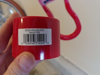

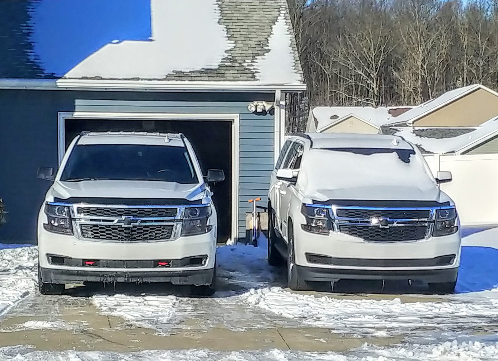

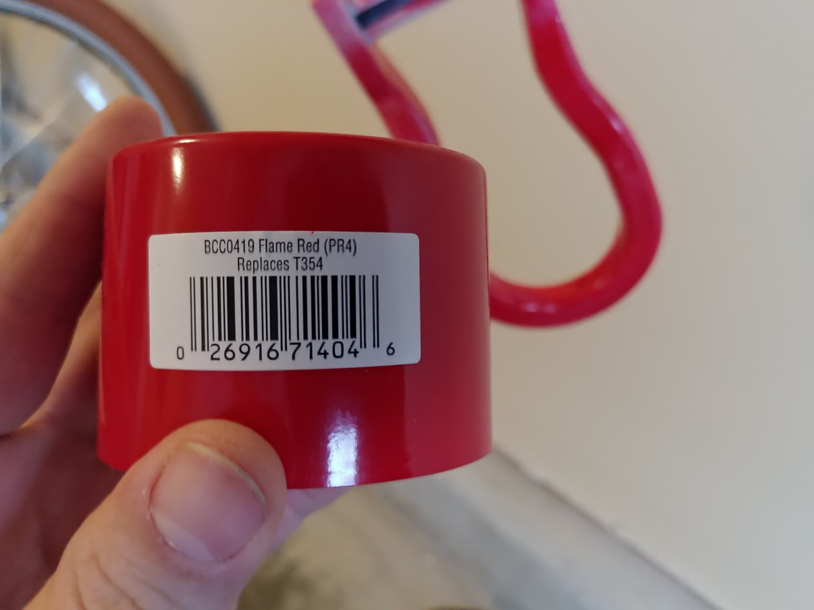

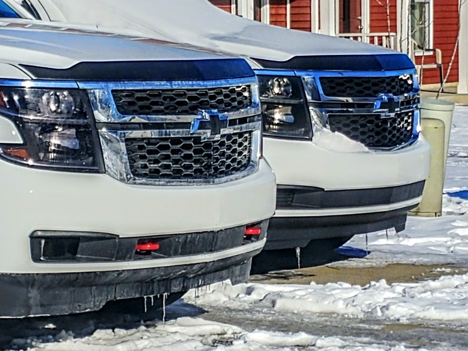

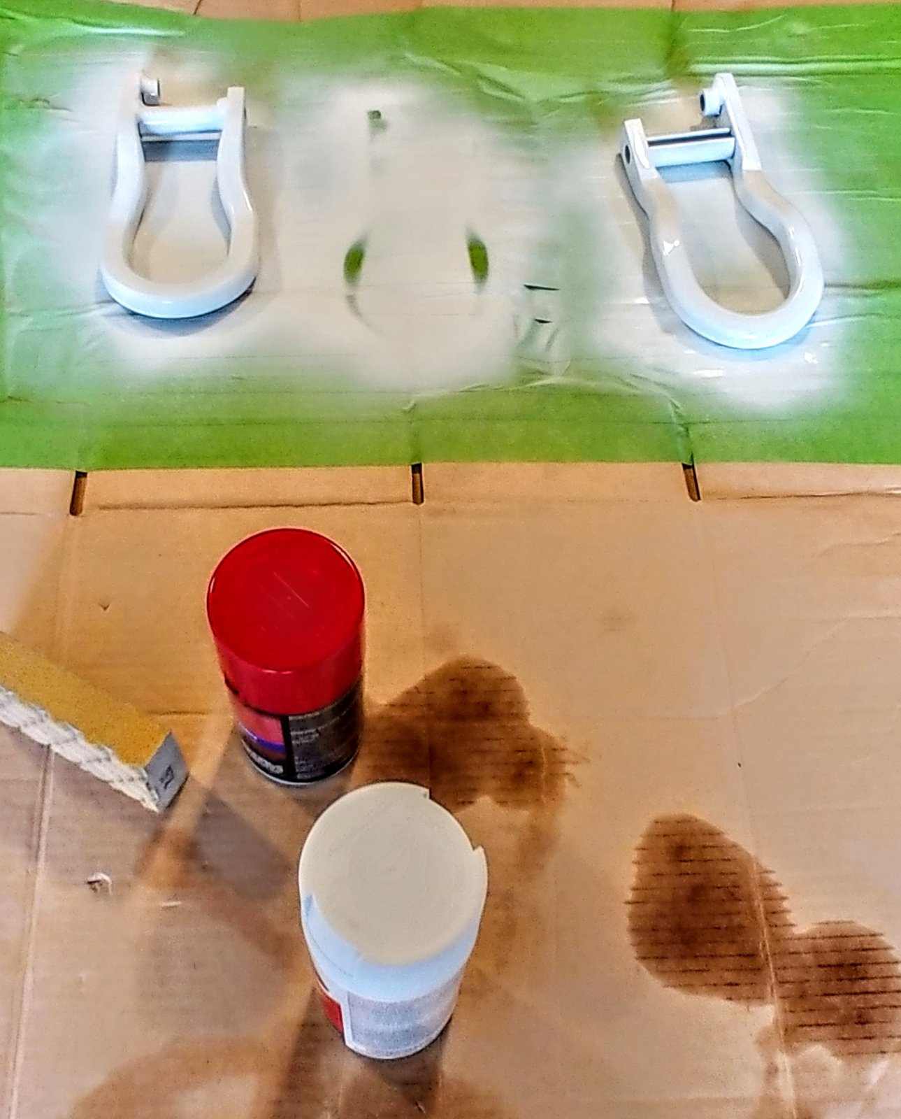

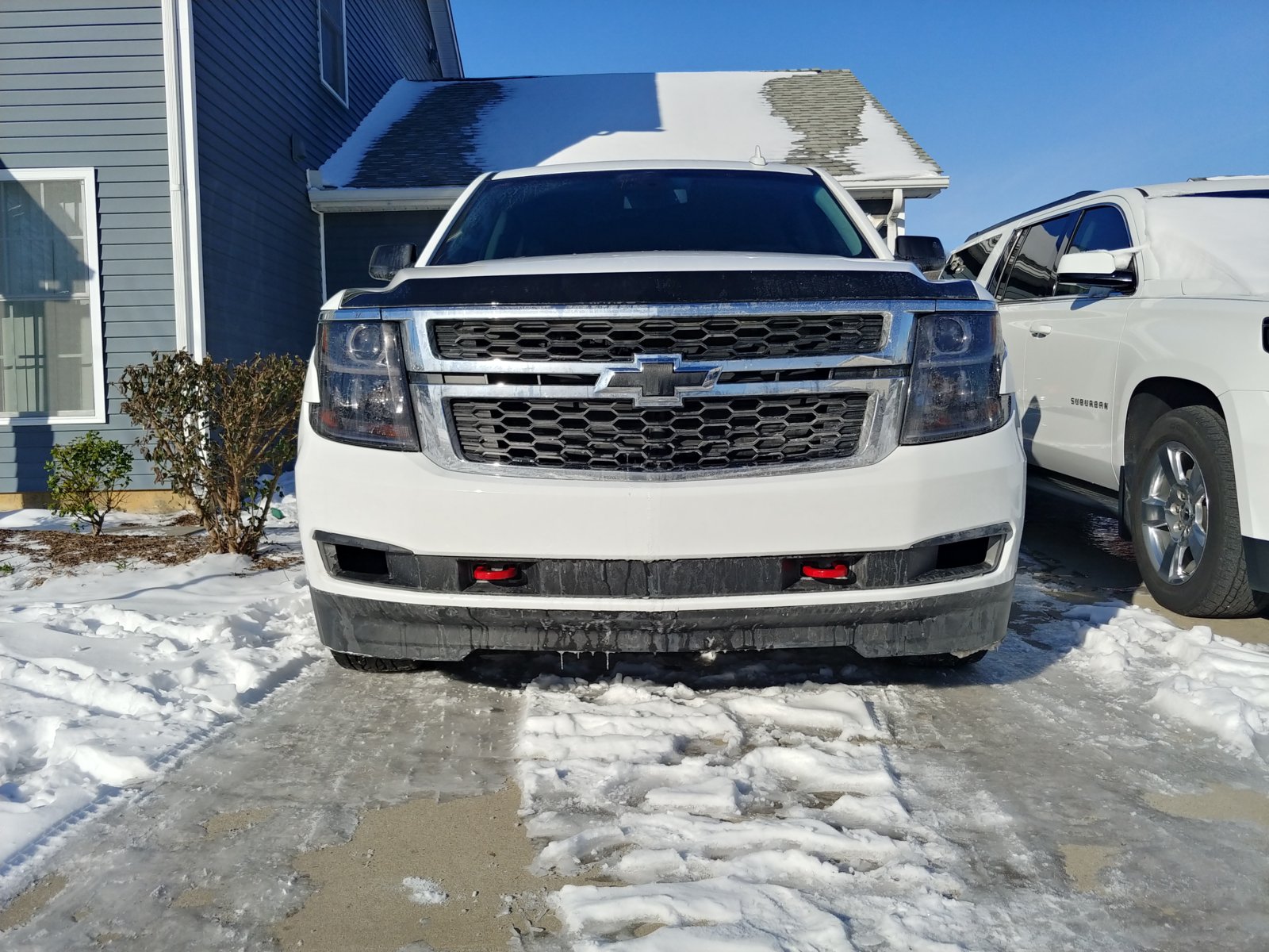

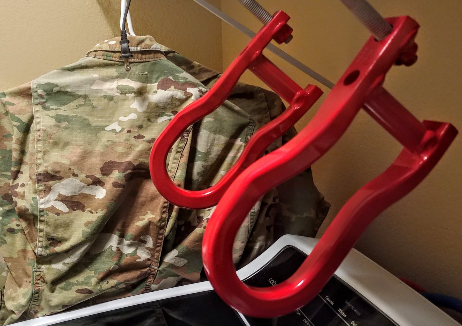

Was at the chevy dealer today picking up the tow hooks and saw a Silverado with red tow hooks. I thought it looked pretty sharp so I thought I'd try it out. Worse case scenario I don't like it and can change it back to black. Installation to come.

Looks great! I like the red tow hooks.

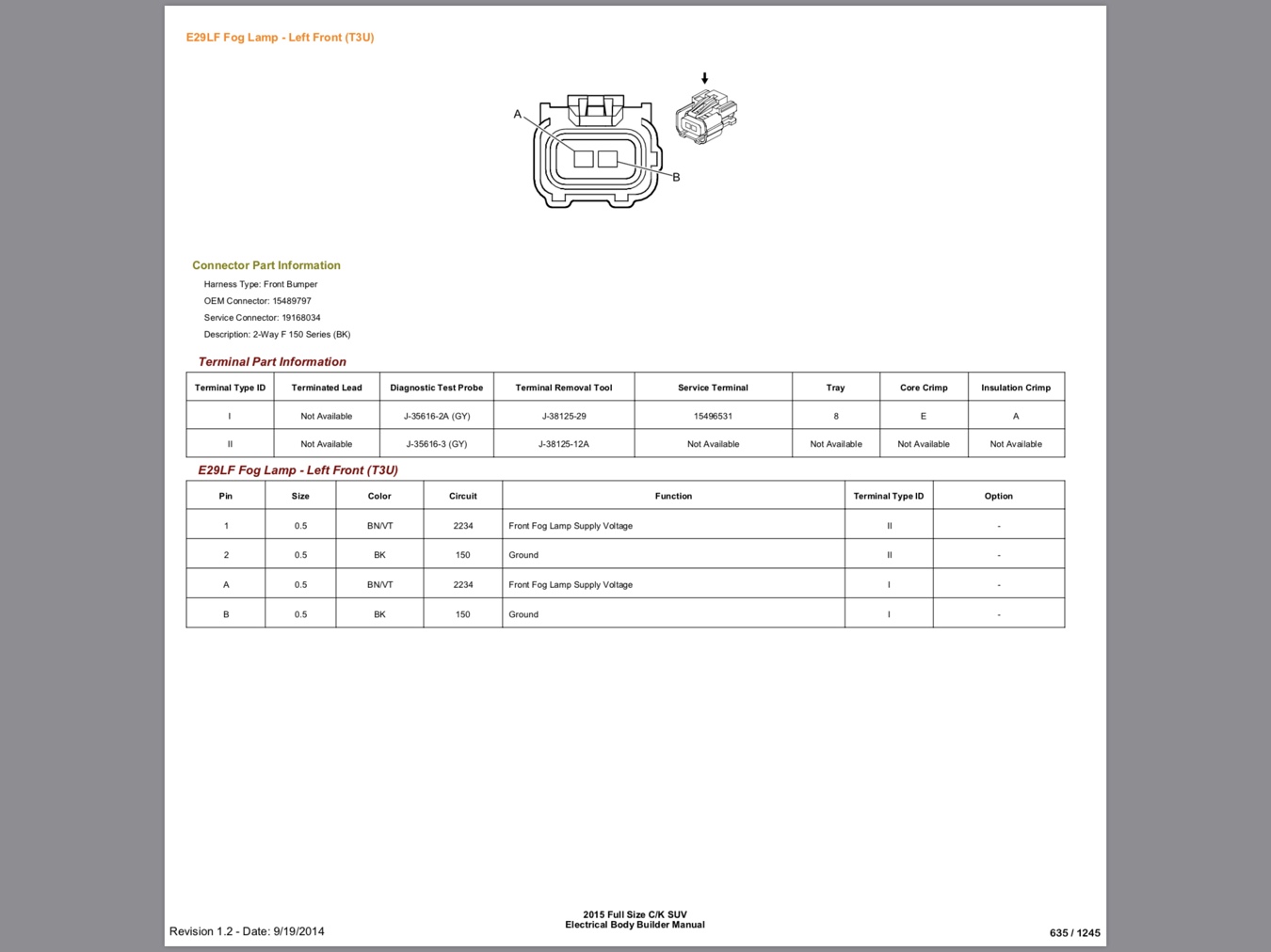

How are you doing the wiring for the fogs? I make a number of different harnesses for the suv platform and am working on an OE type solution for the fog lamps. I have a SLT Yukon with fogs already, so I need an suv without them to see if this solution will work.
My intention is to follow the factory harness path going through the connectors in line back to the under hood fuse block. I’ll need your help in verifying if certain wires are present, etc.

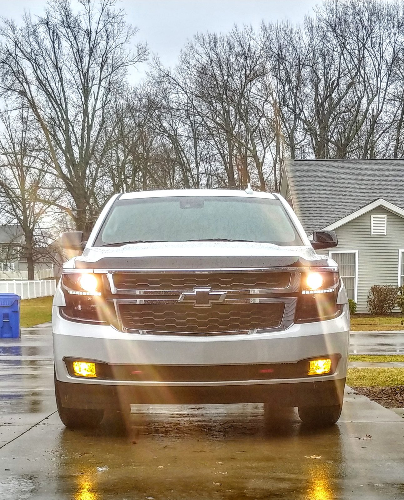

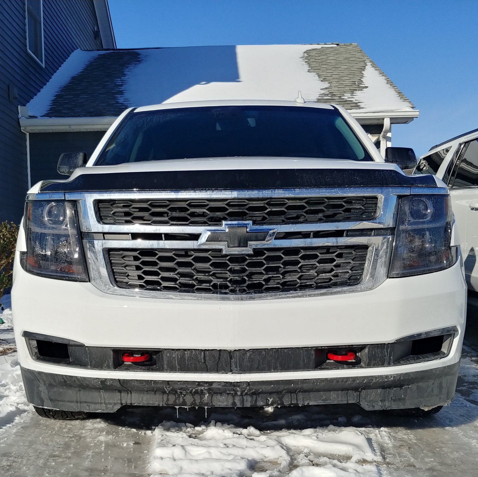

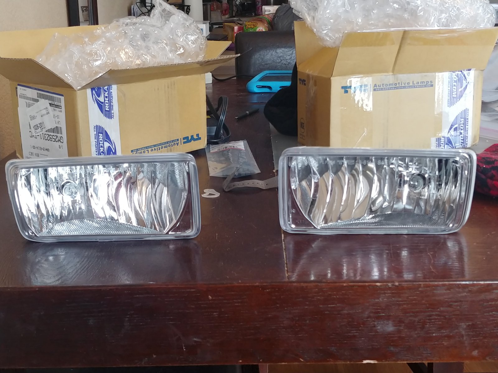

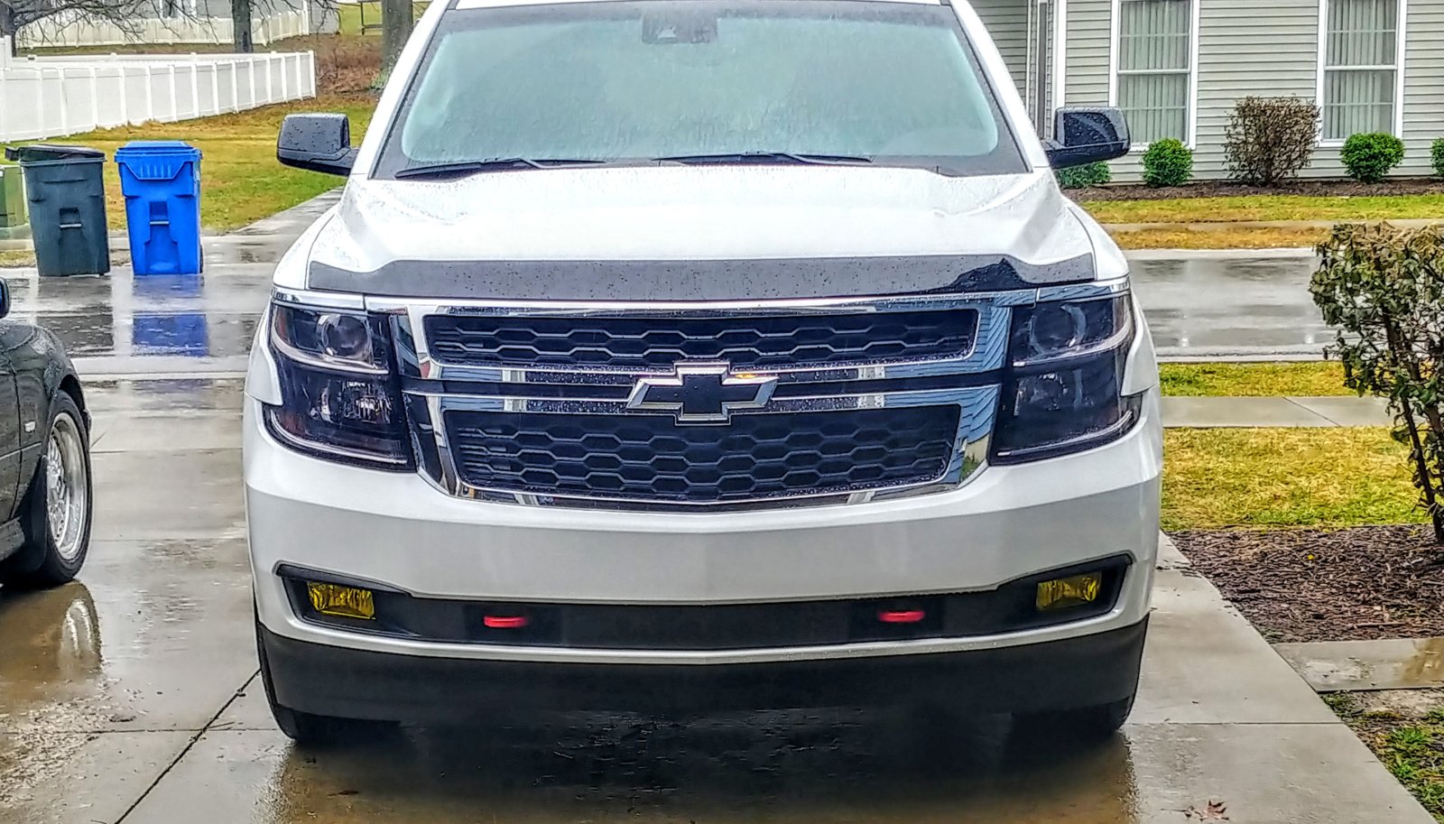

Tow hook installation complete!
Still adjusting/tweaking them to my preferred angle and trying to get them evened up.
Fog lights come in tomorrow.

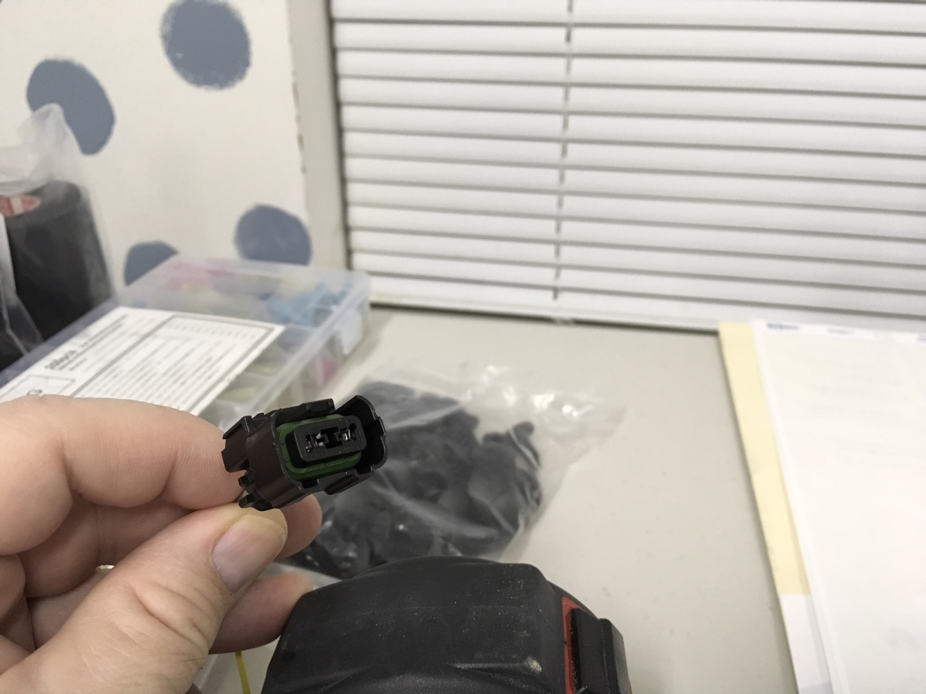

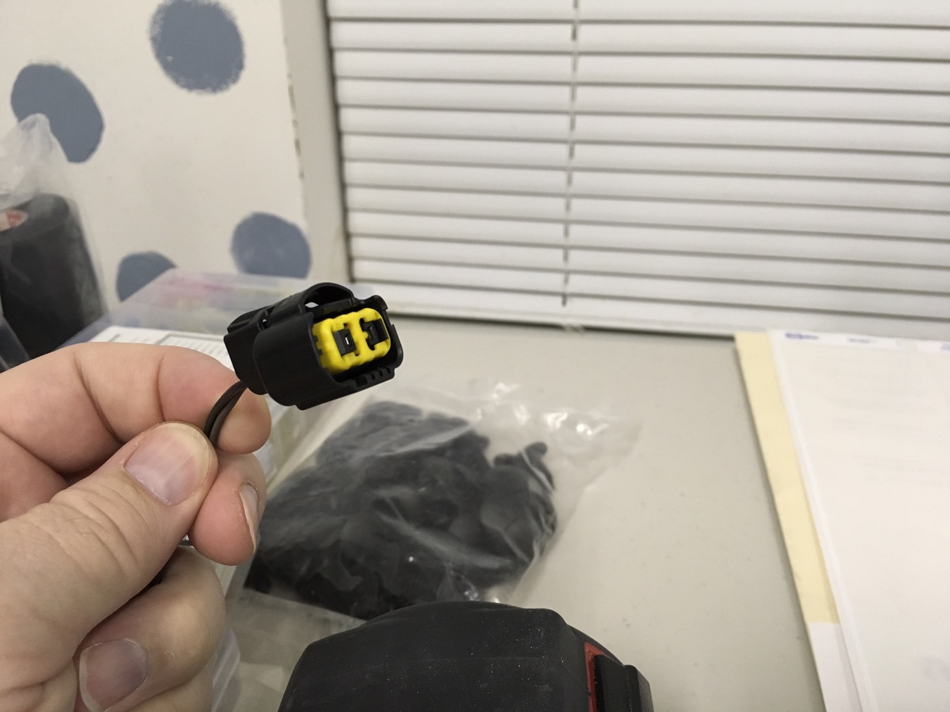

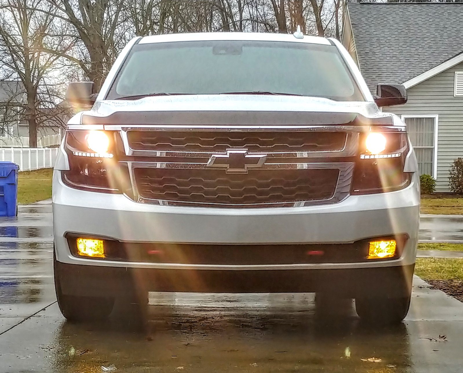

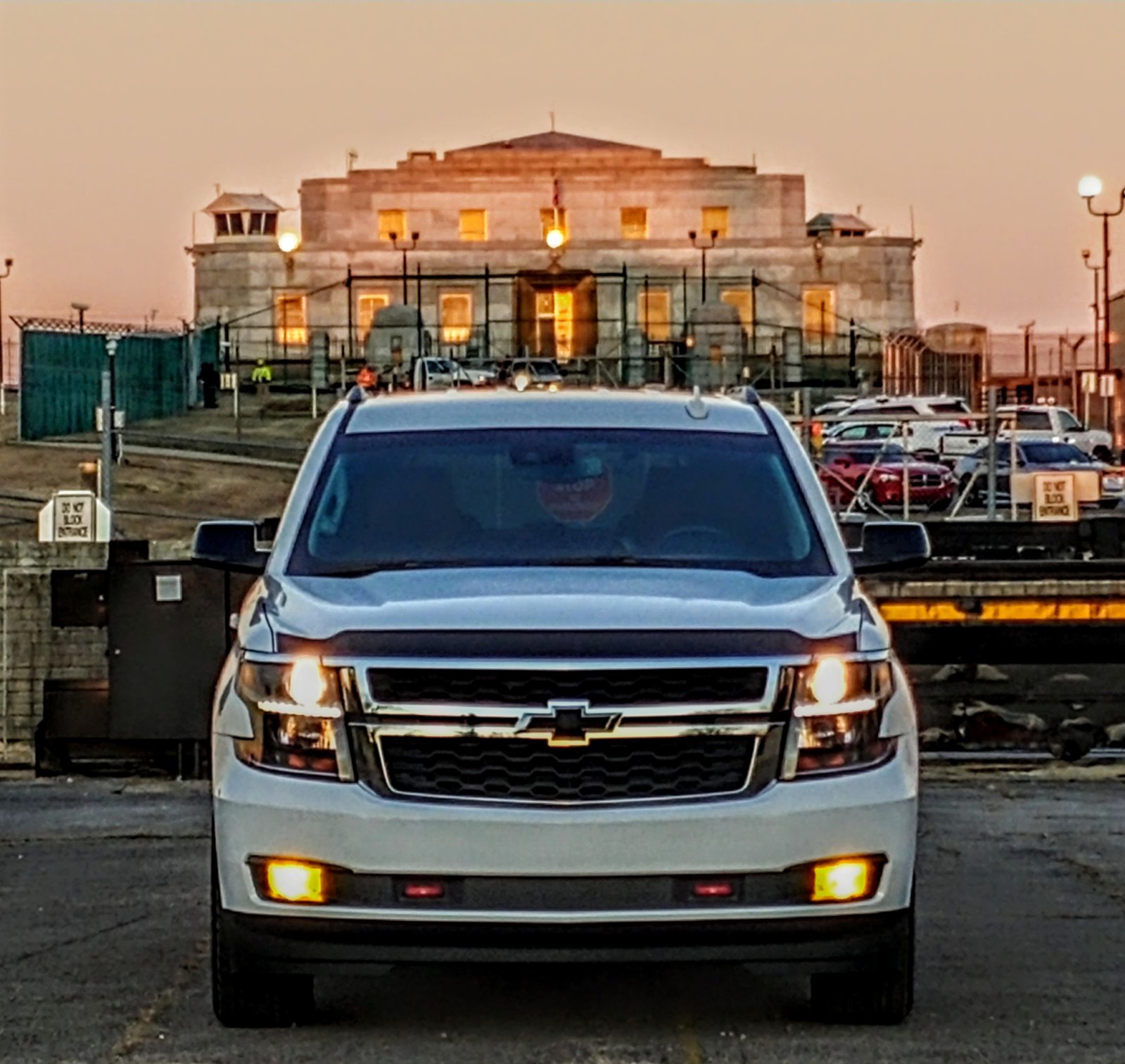

I will be using the gen5diy harness which is a pre made harness that plugs into the low beams. When low beams come on it triggers the relay and turns the Fog lights on.
