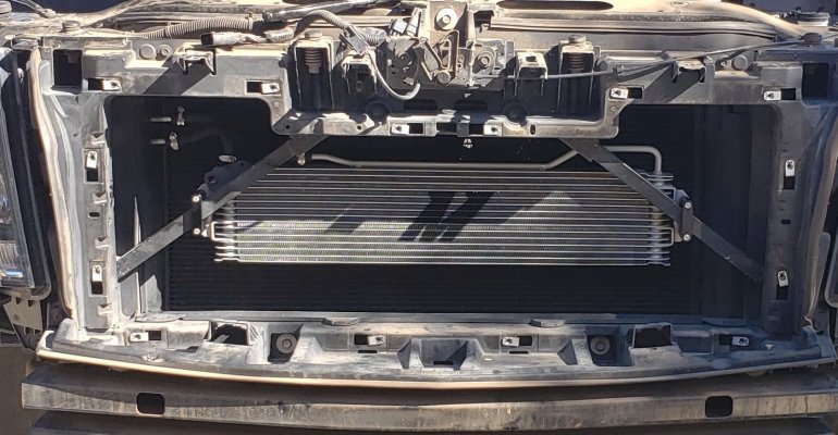

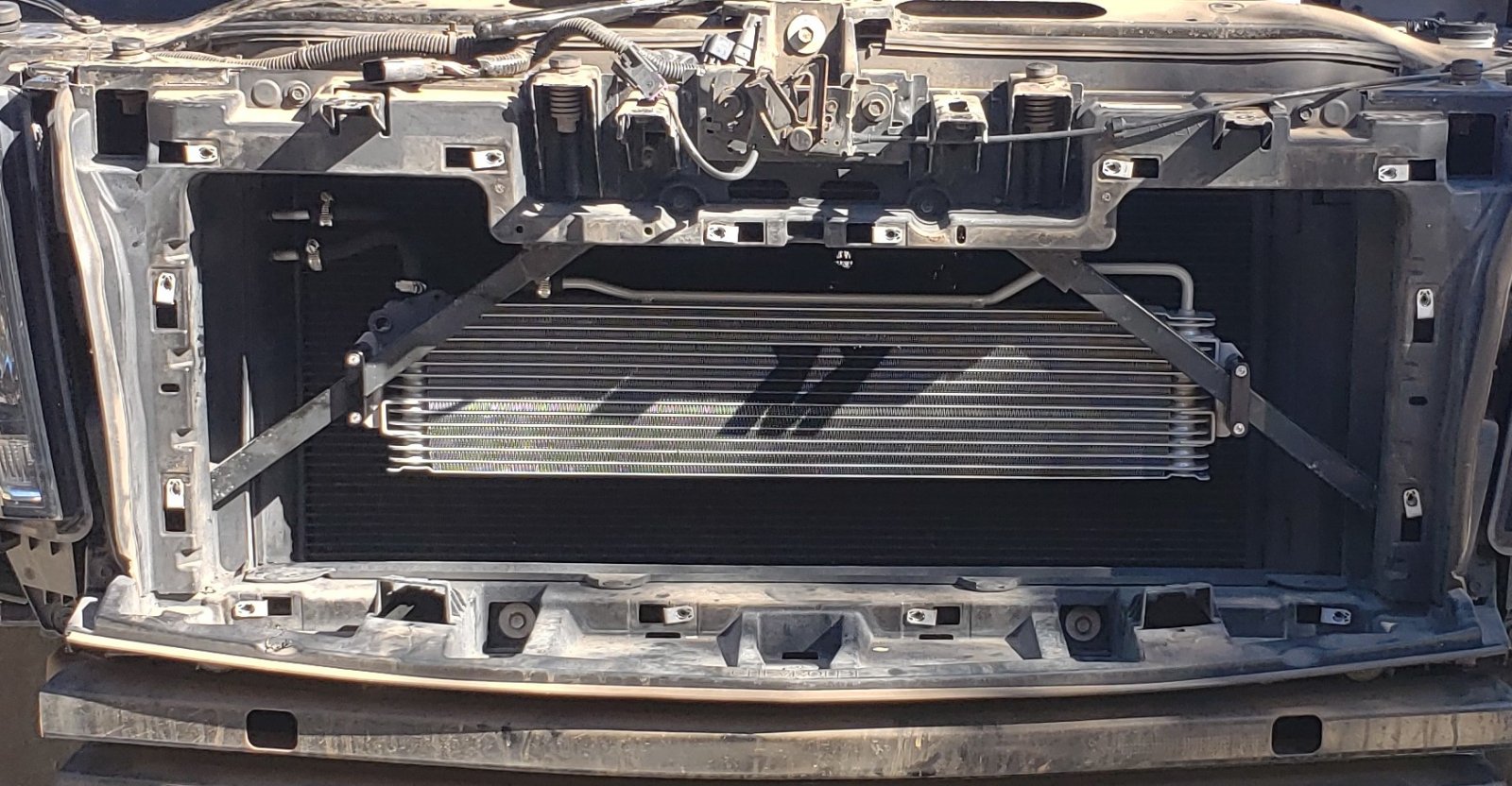

used the Mishimoto MMTC-K2-14 Transmission Cooler kit for a 2017 Chevy Tahoe 4x4 Premier.
Amazing kit. Works excellent. High quality kit. Not too hard to install, but have to take off the front bumper. Kept the thermostat in place, so the cooler only gets used when the thermostat turns on at like 180-190. But normal operating temps I heard was good for the transmission. above 210-220 bad of course.
I don't think its ever gone over 200 or 210 now while towing up steep grades in > 100 F weather.
