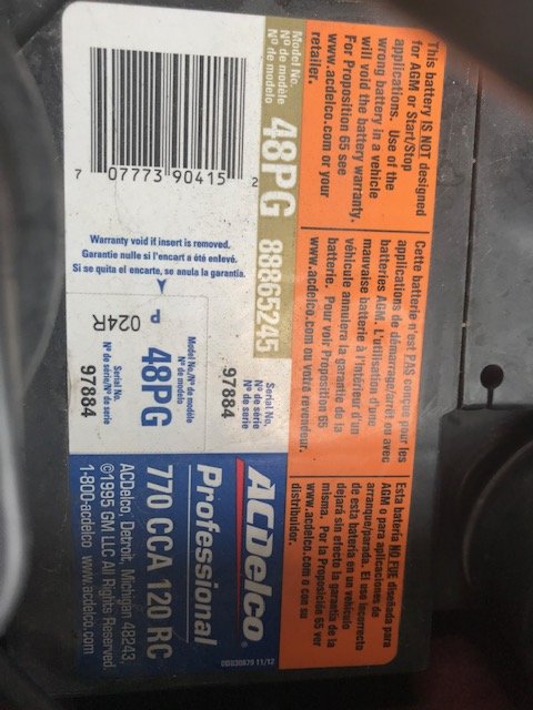

102k miles Wow that is great for a 10 year old vehicle. On your issues I have read on other forums that what you have described matches the symptoms of a bad 12V battery? If it has a AC Delco battery in it now the date code is on the top and probably starts with a P? the first two numbers are the month and third number indicates the year of manufacture The last digit (a letter) indicates the plant of manufacture. Here is a pic of mine in an 09 Tahoe Hybrid (198k miles) with the AC Delco 770 CCA supposedly a very good battery for these units?
The number on mine is P024R so it looks like mine was manufactured February of 2014 and is quickly approcaching the 5 year mark, which makes it pretty long in the tooth for a 12V auto battery nowadays. I just had my local auto parts store test it and it tests GOOD but it is still suspect if I start having oddball problems such as you are having. Please post back if you have resolved your issue and what the actual cause was. That info could be invaluable to the Hybrid owners out there that are risking their hard earned dollars on an obsolete technology that is bound to fail! Hahahaha

It is easy to overthink these issues, from what I read it was most likely the 12V battery. I hope that he installed a new battery and is good to go. On the Hybrids the hybrid battery actually cranks the engine over so people are waiting for a slow crank to happen and it confuses them that the 12V under the hood could be bad and the engine still cranks like crazy at around 700 rpm LOL. Electronics do NOT like low volatge. and the 12V under the hood supplies power to all the electronic controls. Could of course be a bad battery ground cable too that is a known issue and should be checked.
