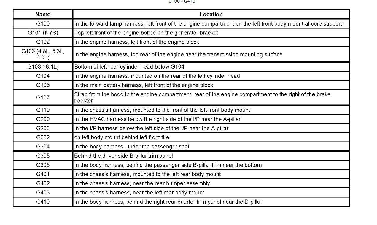

First thing I would check is battery terminals and leads, they get corroded. Then the various grounds. Of course this is all IF you battery actually is good
Cables are very clean.
I just cleaned grounds under the driver door on the frame and the one that goes to battery by the radiator.
Still same result.
Still dont know where the main negative cable goes tho. Any idea?
