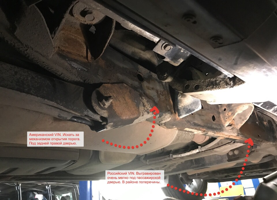

I found a picture, though in Russian. The bottom line is that the American VIN is under the rear right door, apparently, behind the threshold mechanism.
If it's not there, then it's probably already rotten. Unfortunately, this is a common problem for GM vehicles in Europe and Russia. In Russia, for this, an examination is made and the VIN is applied again.
