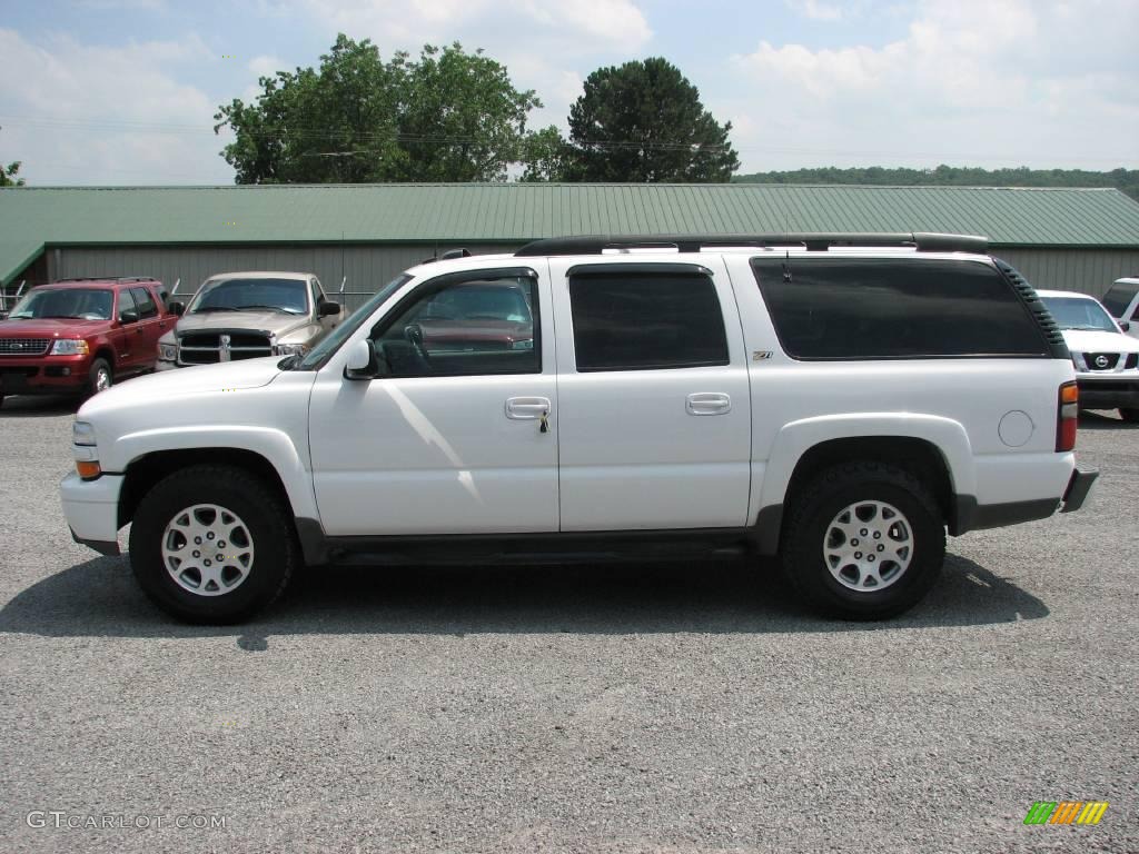

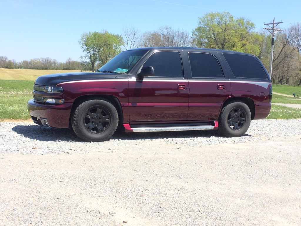

Normally, I'd be inclined to think that maybe the PO bumped into something, but I noticed that almost every GMT800 SUV I've seen has this same problem. Here are some photos I swiped off the Intertubes:
So I figure either everybody who owns a Suburban/Tahoe is a terrible driver who bumps into things at random, or else this is just an example of sloppy fit and finish by GM.
