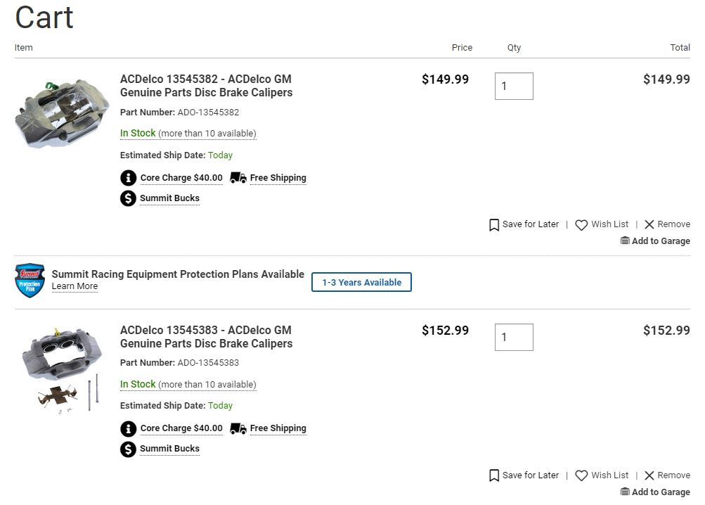

2021+ Tahoe PPV heavy duty calipers and rotors were about 99% direct replacement for my 2018. I needed washers to center the caliper on my rotors, only caveat for me. Multiple helpful videos documenting it on YouTube.
Do you have a part # by any chance?
