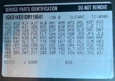

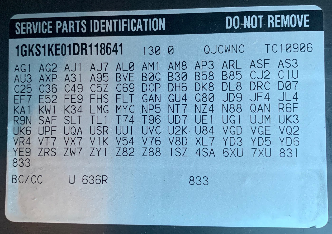

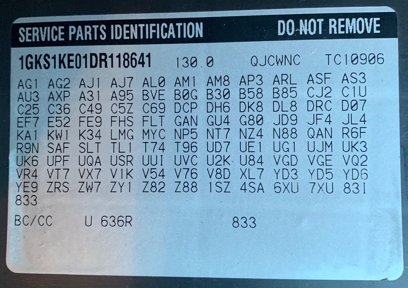

Is this where i would look for the DL3 option in my Yukon?
Da90
Jun 16, 2009
736
815
Tulsa, OK
hmmm. Only see a DL8, no DL3
DL8 identifies non-powerfold mirrors.
DL3 identifies powerfold mirrors.
You need DL3 mirrors and window switches to swap yours to powerfold. Your truck will be a DL8 truck with DL3 mirrors.
