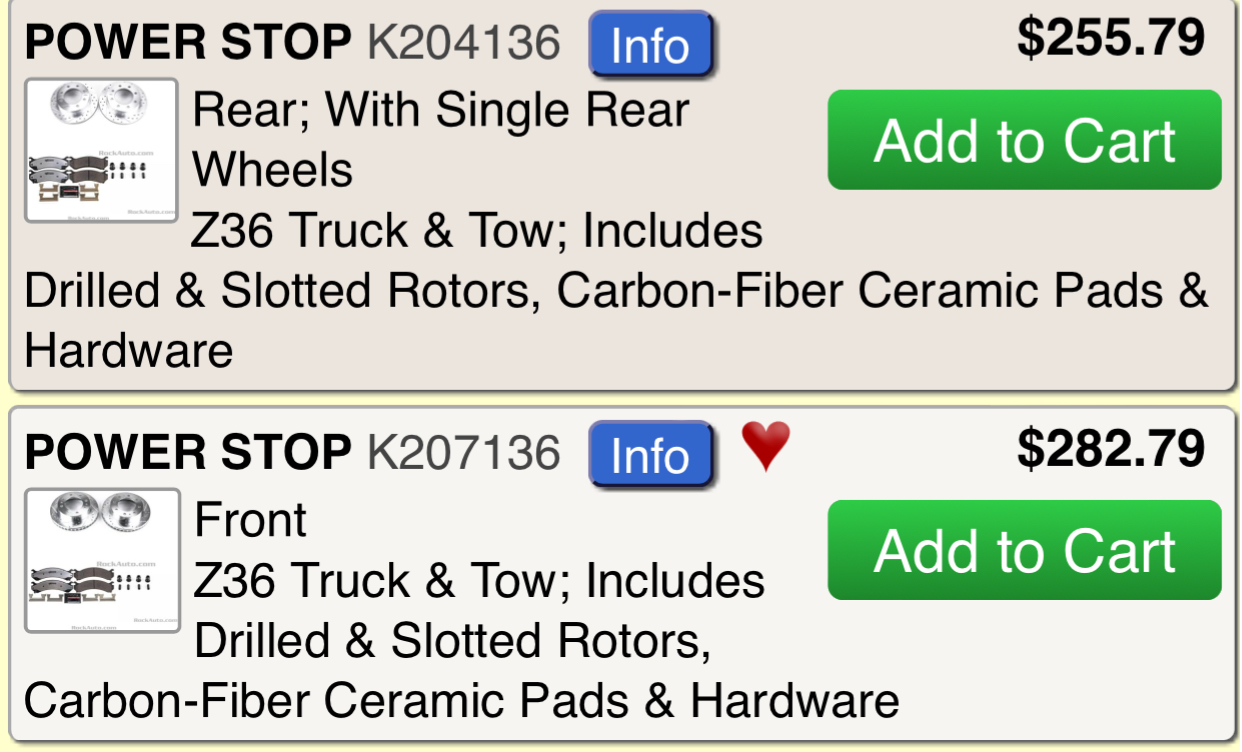

The 3/4T brakes on your 2010 are thicker than its 1/2 ton sibling. The best bang for your truck is the OEM size that are cross drilled, counter sunk and slotted hot zinc galvanized rotors with ceramic pads.
My buddy used the same kit on his ‘13 3500 Silverado double cab ext bed 6.6L Duramax. He regularly pulls a Bobcat & trailer made cement mixer in his 22’ dump trailer on this set up.
It’s the same set up I run on my 09 Esky, Audi & 07 VW Beetle Vert obviously smaller in size.
If you want new calipers they have a kit that has powder coated clampers.

I thought I had read a post or two on here that really liked the Powerstop rotors, but separately suggested against something of theirs.
If I remember one had some rusting on the calipers and the other didn’t like the response from the pads included in the kit. Did your buddy get the red calipers & did he upgrade anything else while at it? Brake lines or the MC?

He got the rotors & included carbon / ceramic pads from AutoAnything as a kit for all four corners. No replacement on the calipers though. This was two years ago. He was having the same issues I was having, pad material building up on the rotors causing brake pulse.
He’s taken the truck back & forth from San Clemente to WA State & OR a couple times since then. He’s a Comm pool contractor. I’ve always used Bosch Ceramic pads and impressed with the pads that were included in the kit he got. He didn’t do the brake lines, just a flush while apart. I doubt anyone else has installed that kit on a 3/4 or 1T truck / Burb yet.
