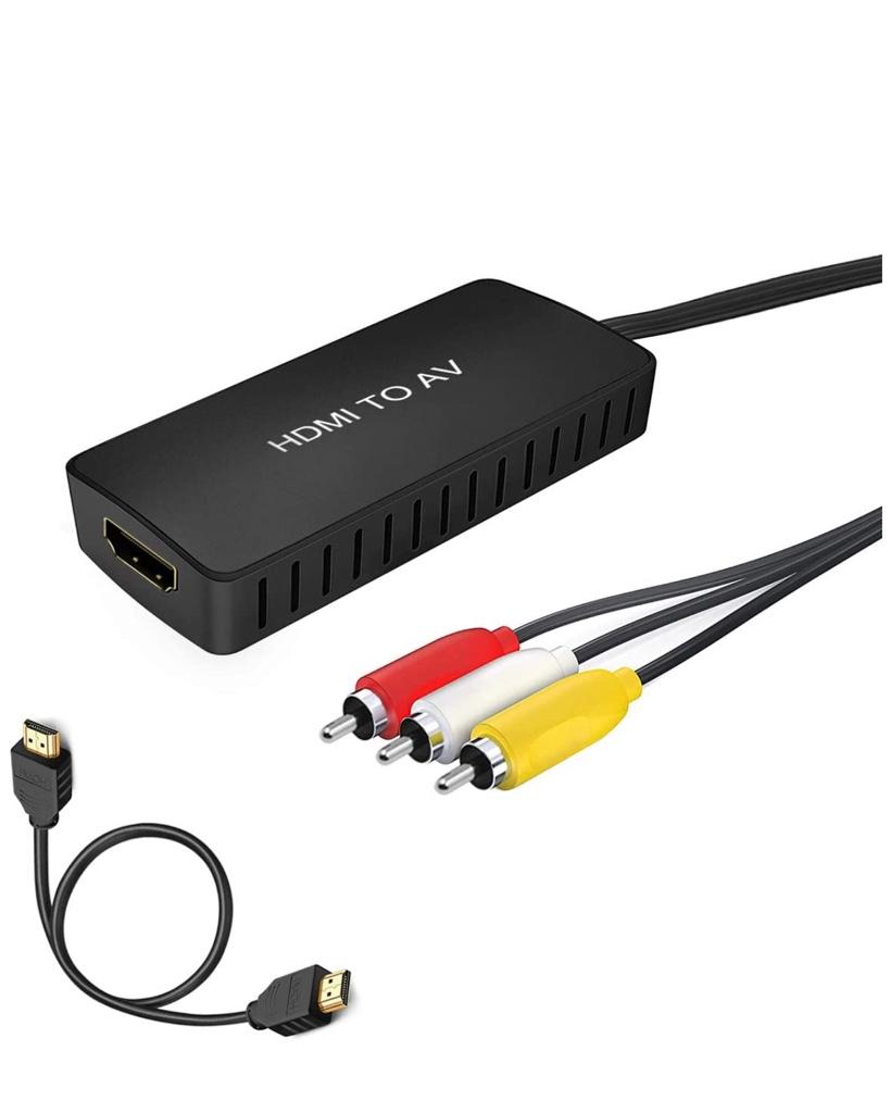

I have not done this but assuming for iPhone... av video adaptor to hdmi to hdmi/lightening adapter.
